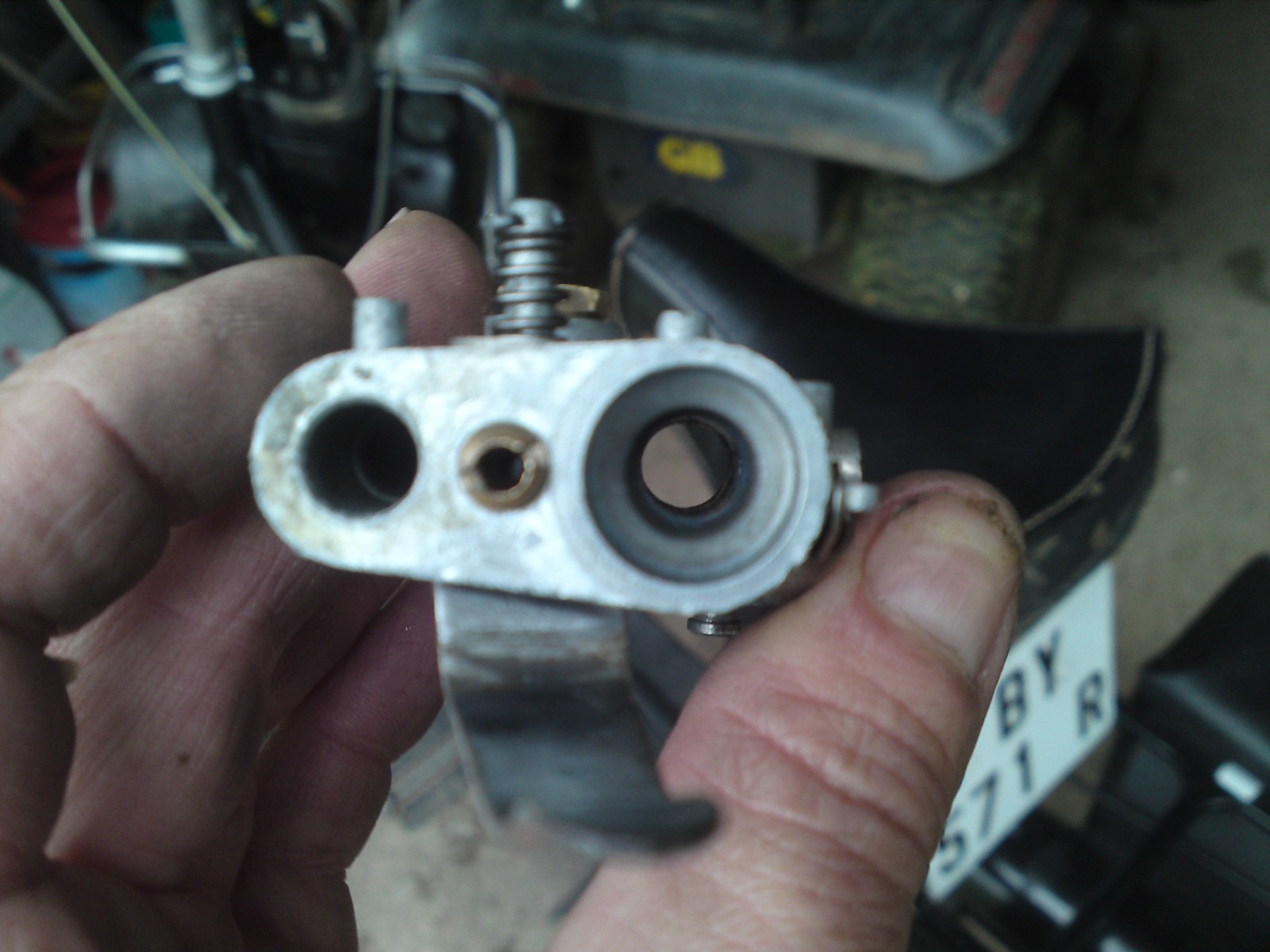

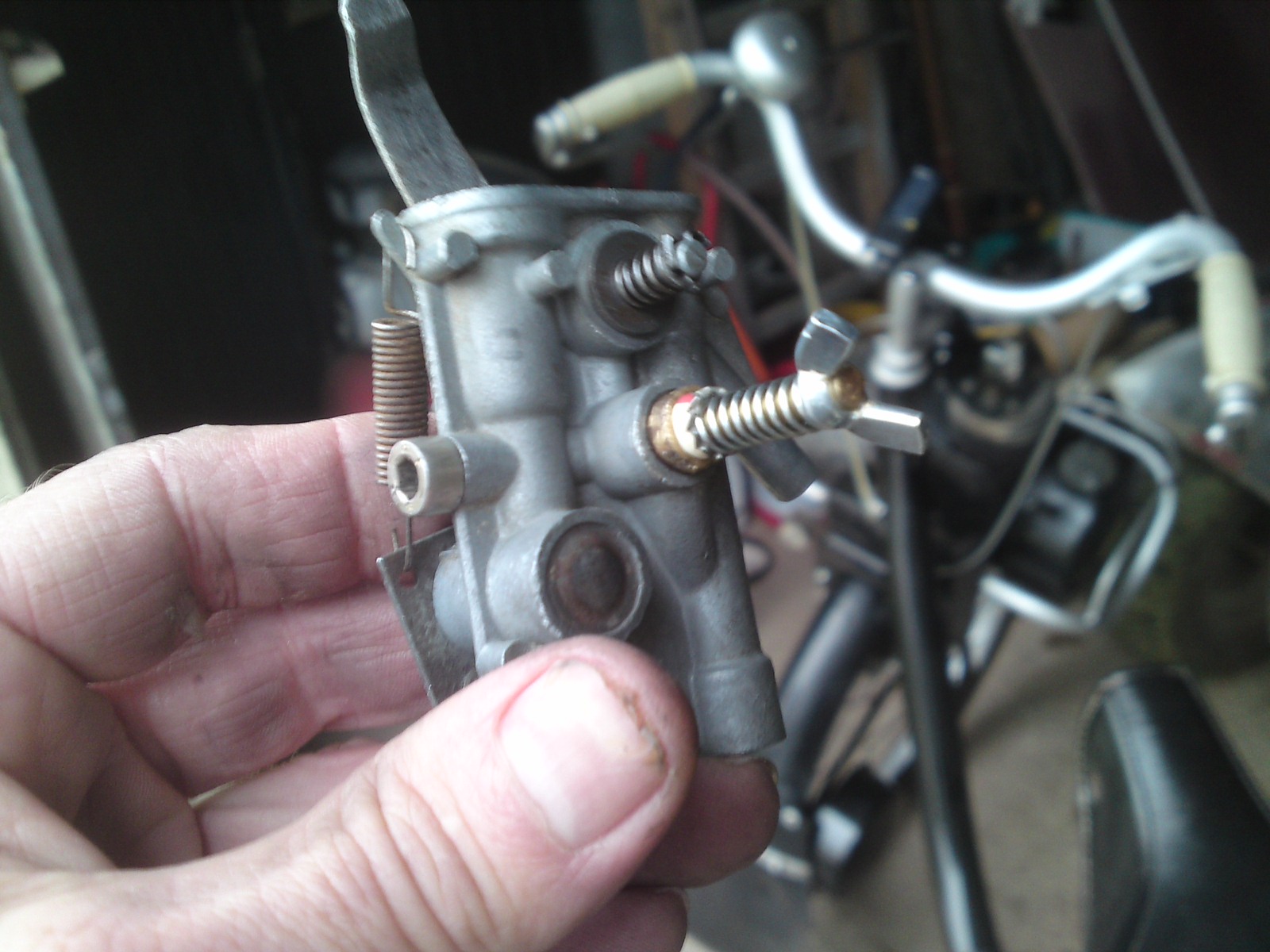

Finally had modified carb and adjustable jet today. The first one he sent me was not for the 2200 as I stated. In the end I send him my carb and modified that. The bore is now 9mm instead of 6.5mm (I think). On first impression the adjustable jet is a good idea as can alter the mixture on the run. 1/2 a turn in sweet spot goes from rich to lean. Tried with normal air cleaner on and with no air cleaner and black cover and had to adjust mixture because more air (as it should be) but cannot see great difference to original set up. Also because jet is sooooo long you have to remove the little plate that runs down the frame behind engine. In short - adjustable jet :) modified carb :| :|

Quick up date - was not happy with length of jet so found he had only glued the wing nut onto the thread so cut the spring and placed lock nut onto thread and shortened the whole thing. Does the same job but now the plate behind the engine can go back on.

Overall I would say it has made a diffference - As video shows can go along nicely at 34 kph on the flat and having the ability to alter the fuel ratio is great. Can do on the move so can tune it. Overall jet 10/10 - carb 7/10.
