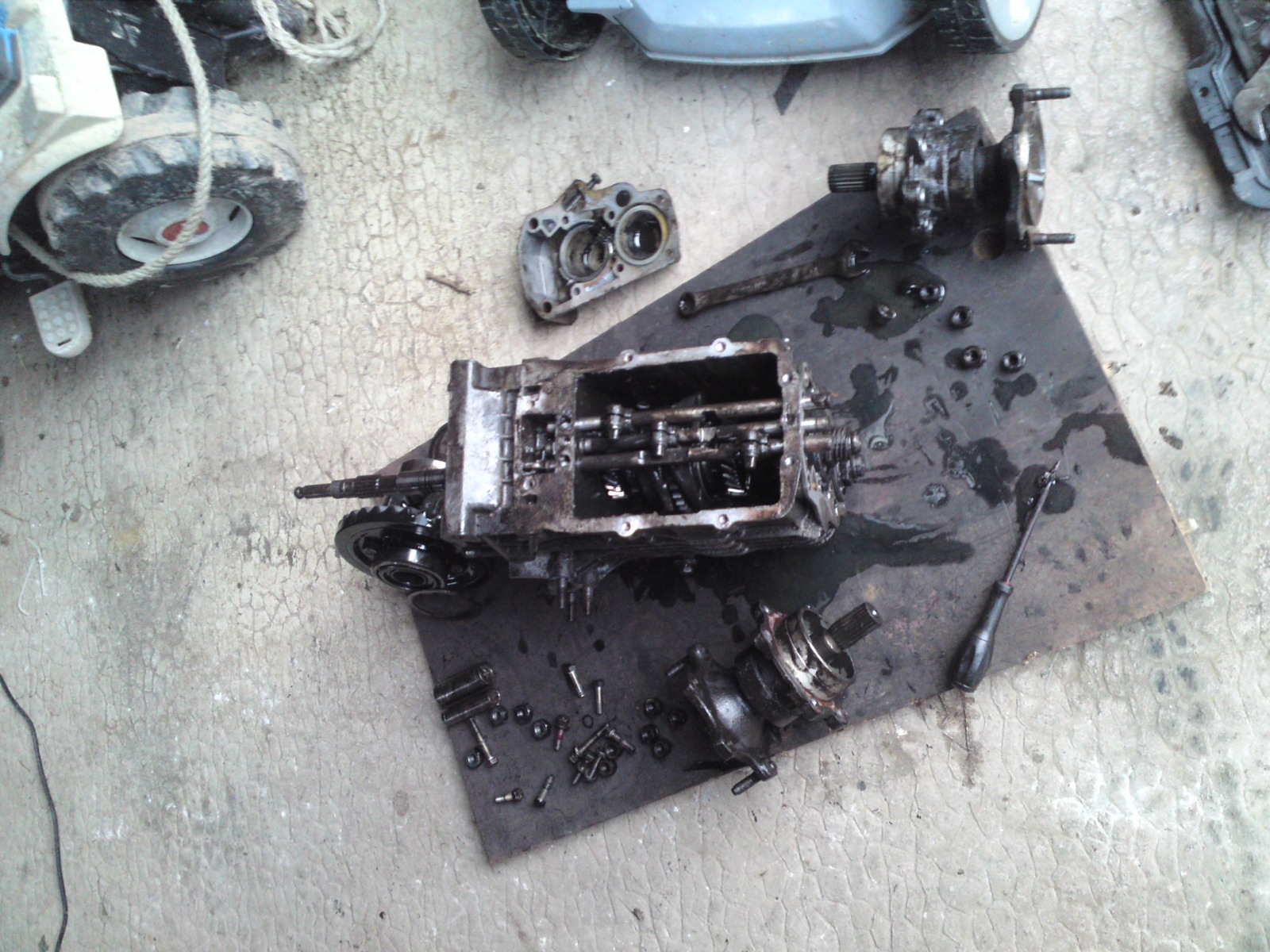

Drained the oil and the plug looked like a Christmas tree!!! Took the top cover off and had a look. Gears look fine (never had trouble changing gear etc) BUT when I engaged a gear and slowly turned the road wheel not only do the gears go around but they move up and down. Think the rear bearing has gone (at least). Will strip out engine tomorrow and box (weather permitting - working outside)
April 28th, 2014, 4:46 pm

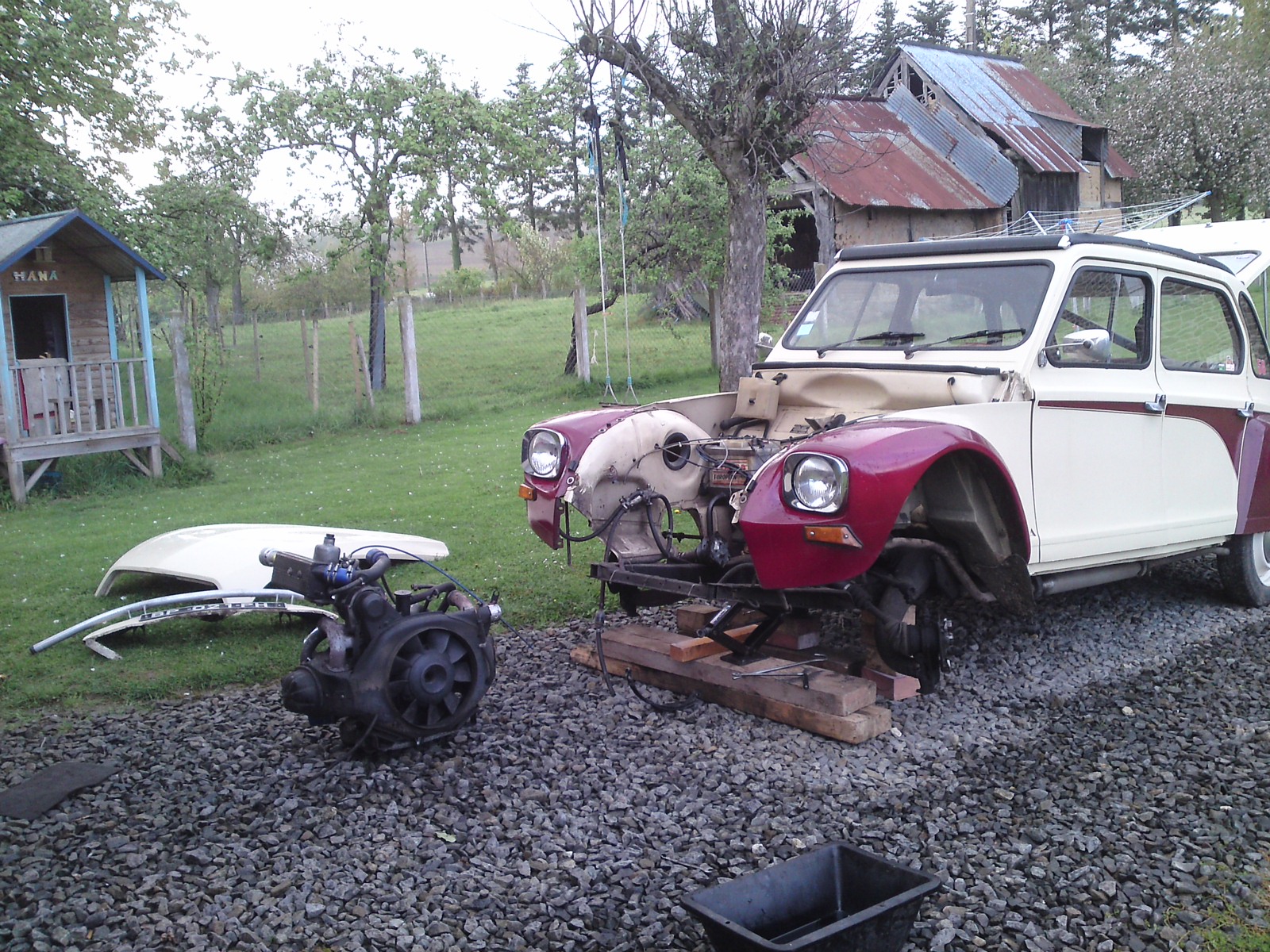

After earlier post had a 2 hour window in the rain so took engine/box out. Took box apart and found the following good points - diff and its bearings good, gears good. Now the bad - 1 output bearing totally gone, the other is a tiny bit rough. Rear bearing where the speedo drive has around 2mm play and the balls are not round. Will totally strip it tomorrow. It seems very straight forward....

Stripped the box down totally. Very straight forward... Parts needed - rear bearing, small needle bearing and hub bearings and seals etc. Total 137 euros from MCDA.
Not too bad....
