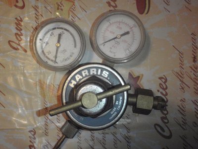

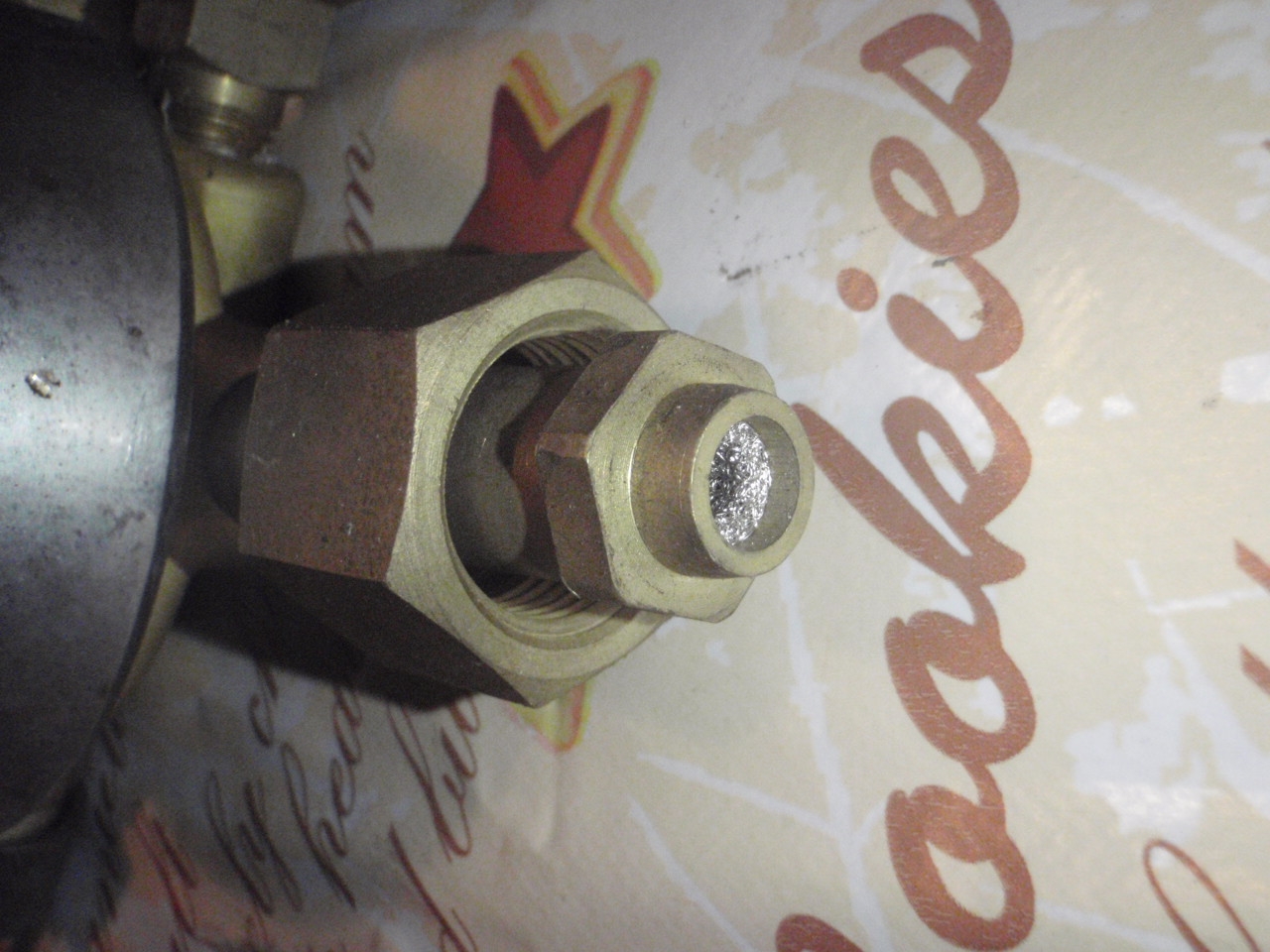

This is what was given to me.

That one is for European bottles.

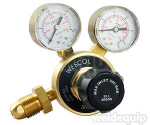

This one is for UK Bottles.

if your getting a UK Argon mix you will need....
or similar

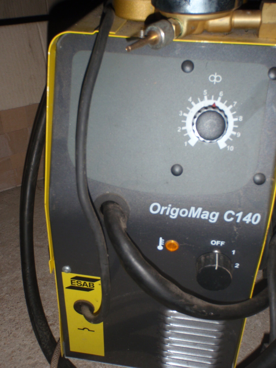

that esab looks like it only has 2 power settings might be worth checking what the minimum aperage is or you could be blowing holes in everything.
http://www.welding.org.uk/esabmanuals/Instruction%20Manuals/Origo%20Mag%20C140,%20C150,%20C170,%20C200,%20C250.pdf
35amps minimum might need a bit of practice to get used to it.

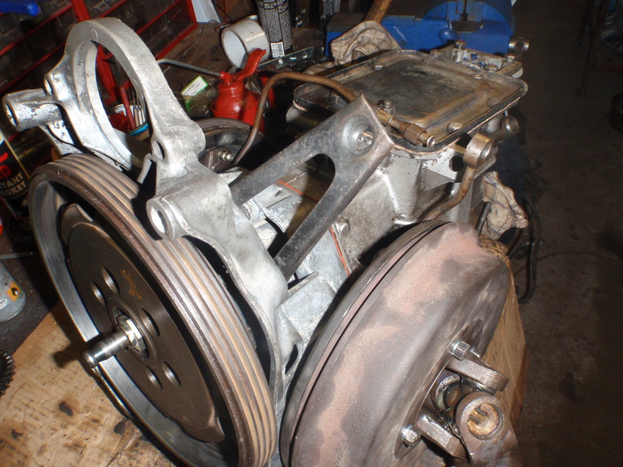

Bloody hell, here we go again. Just finished an old gear box and used the last 2 out put hub seals. Bought stock down under long time ago. Looking for seals in France but nothing available or I don't know where to look.
Since I'm at it, I'll stock up on Visa crank shaft seal, M4 seals too but need to find an online shop in the UK supplying oil seals.
Out put hub seals on old gear boxes are 50x32x10
Any help is appreciated
Cheers
Viking
