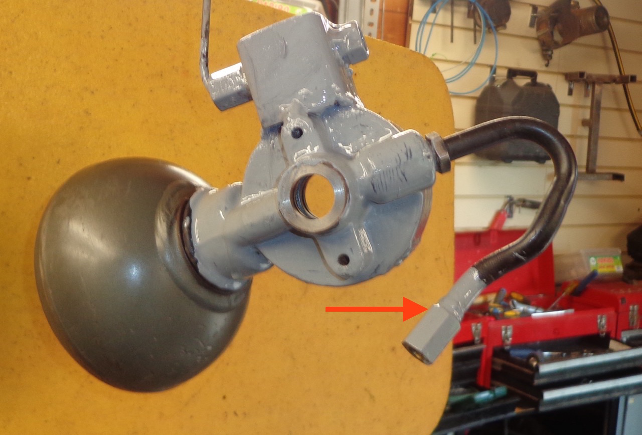

My Rear Strut Tops.
With the rear struts they have M16, but I managed to obtain the pipe with 2 end connections.
With "Tig weld" to std steel 3.5mm pipe union.
See
My Front Strut Top.
The fronts are M10 with a special connections, same as late Xantia.
Hard to DIY fabricate
UK supplier
See http://www.eurocarcare.net/hydraulics/e ... -rear.html.
These unions also fit the pump (BHI) .

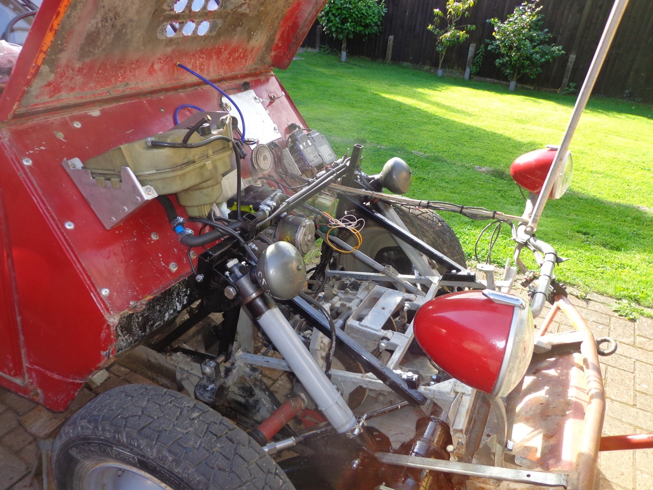

Getting there....
Fill up with Hydraulic LDS oil, wire up the pump and solenoids...and then Test :?:
August 9th, 2015, 10:11 am
Looking great your solution...
However I have my doubts... As far as I can see it by the picture your point where the cilinder is attached to your arm is wrong... When your suspension compresses your arm
(force= arm x power) is getting smaller, so you will need (relative) more pressure to get your hight right.. it should be the other way round when your suspension compresses your arm must getting longer (or at least equal).. my opinion
Hope you understand what I'm trying to say.. That's also why your rear-end suddenly pops up (I guess)...

You're right (as always), but there's the problem with the axle being the other way around, and not enough room to mount things the way it works best.
Maybe the progressiveness of the spheres is just enough to overcome problems.

Rear Suspension.
Rear "Pops Up" as the pivot goes thru its higest point.
