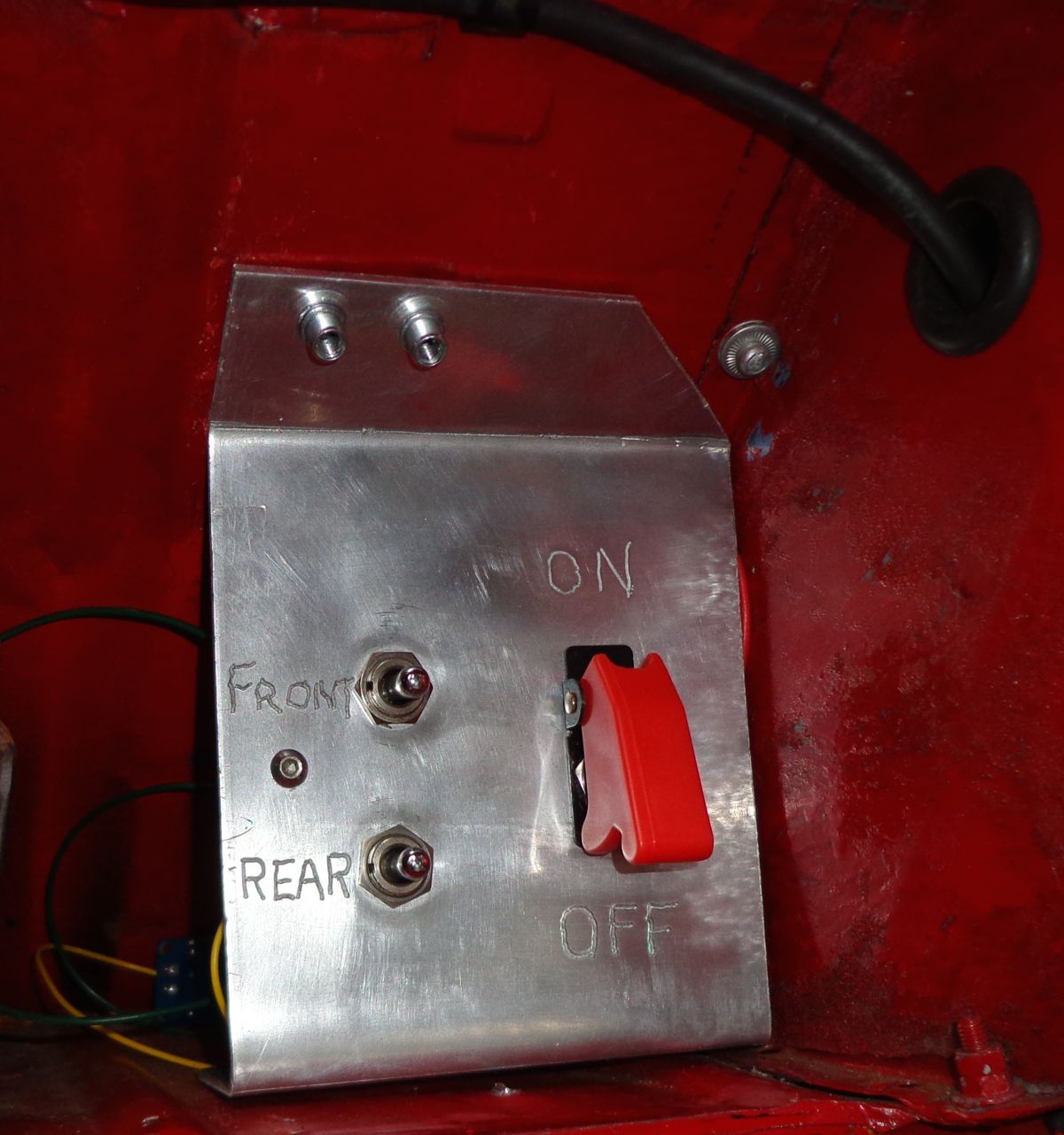

Switch Panel.
Main Kill switch.
Front/Rear Toggle switches to select which wheel.

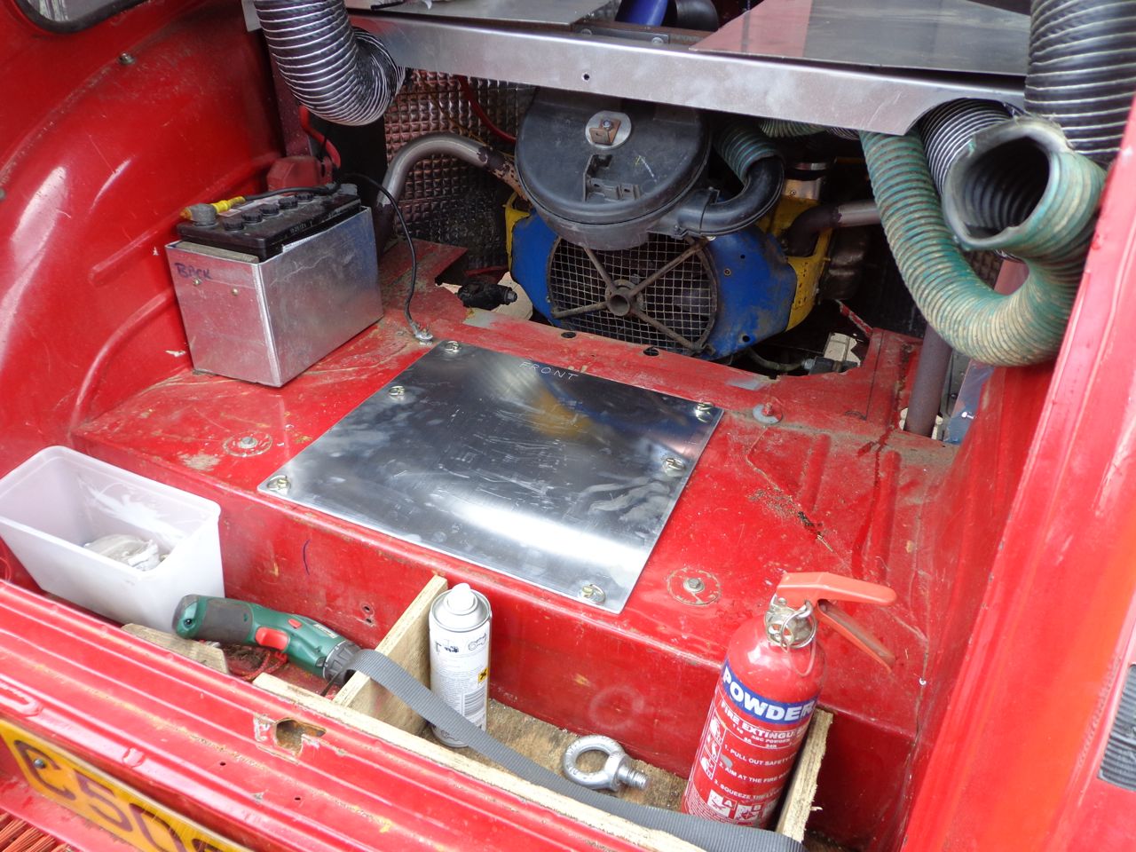

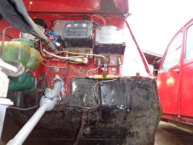

New cover for rear diff/brakes and finished the extra brake pipes.
