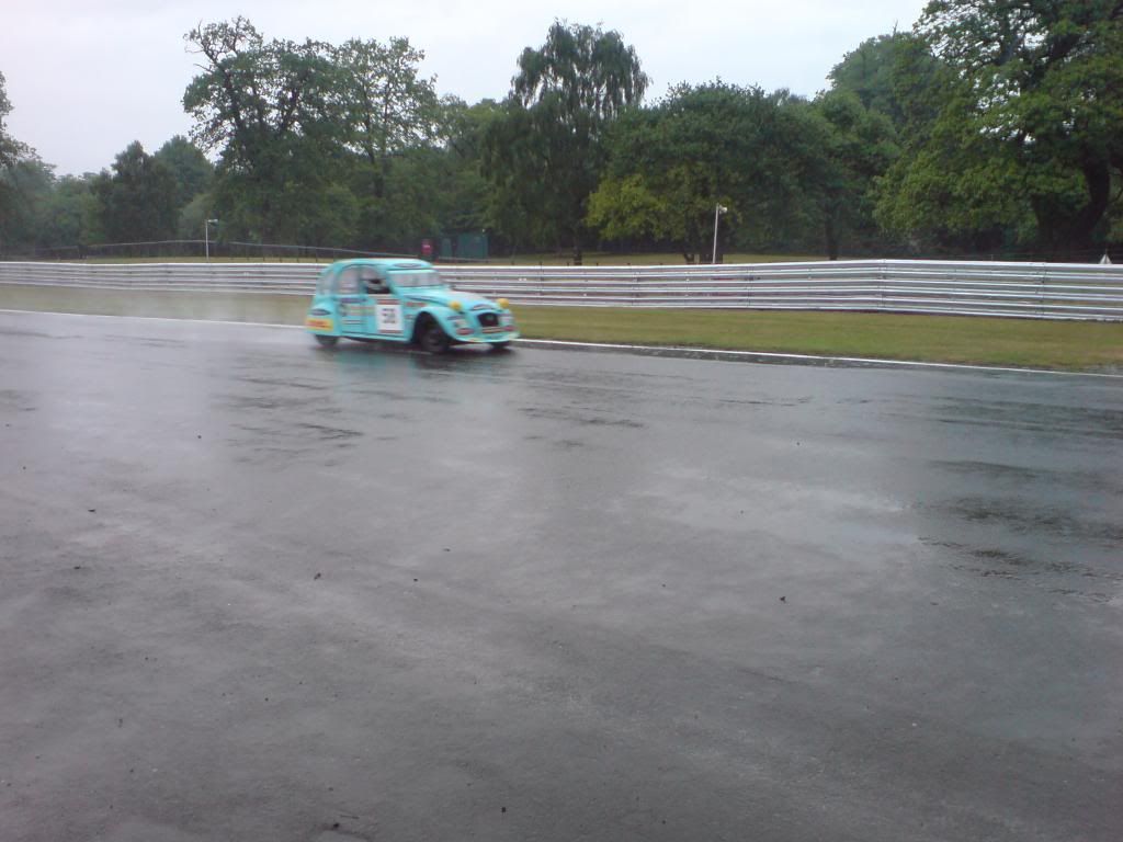

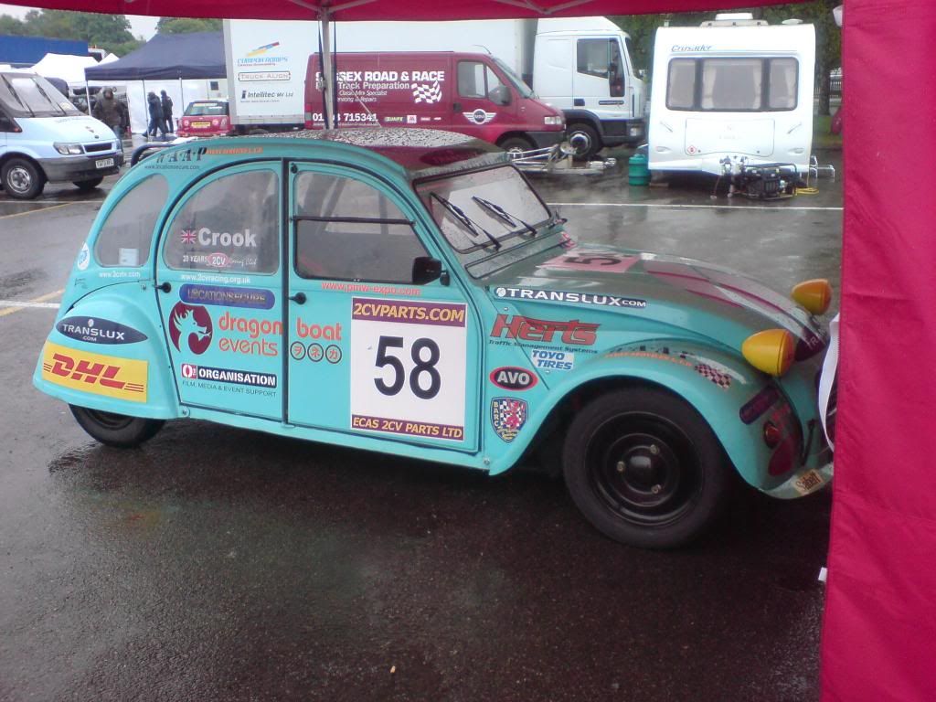

I didn't get chance to get many photos this time out but here they are. All three of them! :lol:
