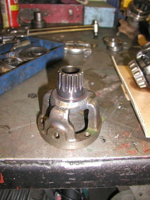

Some pics,
The output shaft is a longer new item,
Deeper new bearing carrier.
Spline welded to diff carrier.
Approx £1000.
This set up is much harder for GS as there is no separate bearing carrier.
