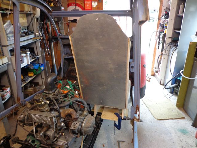

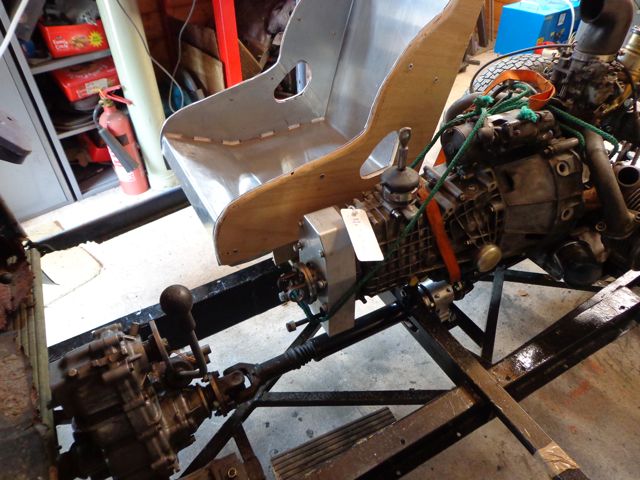

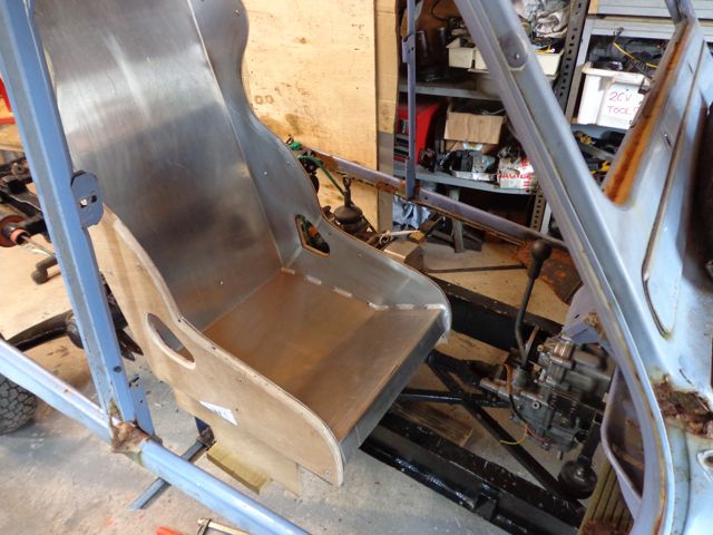

Going to be warm and cosy.

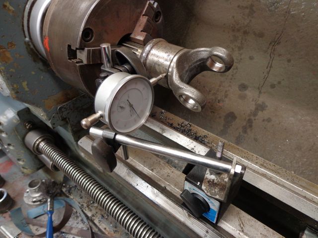

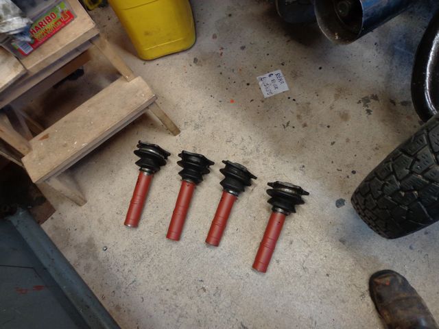

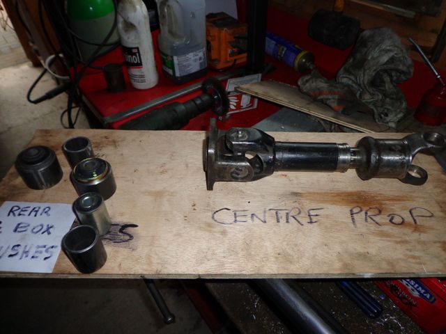

Machined up centre-prop and did some revised rear gear-box bushes and the first of 4 drive shaft extensions
Drive Shaft extension
Checking prop shaft run-out.

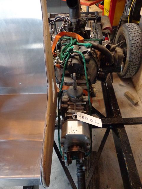

Last few days.
Drive shafts + extensions.

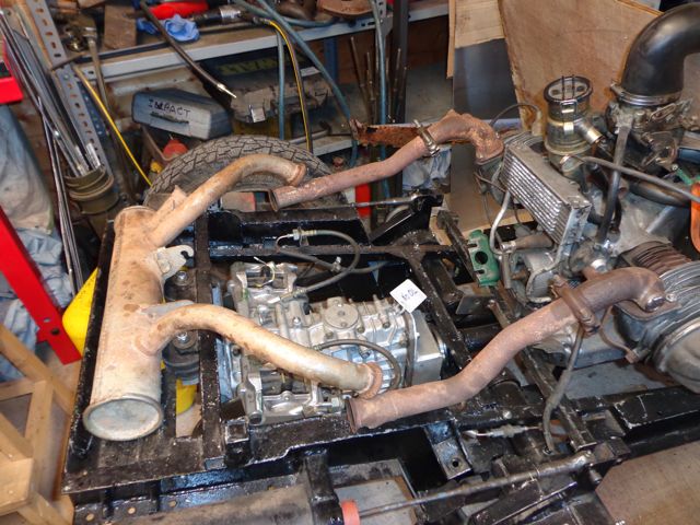

Exhaust with some standard bits - re-arranged.

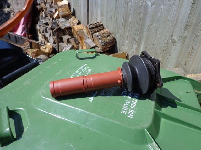

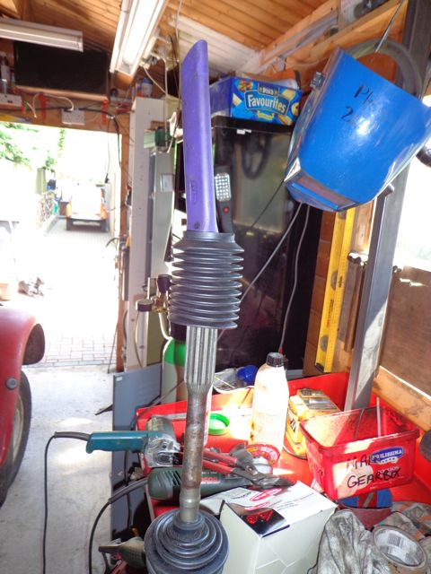

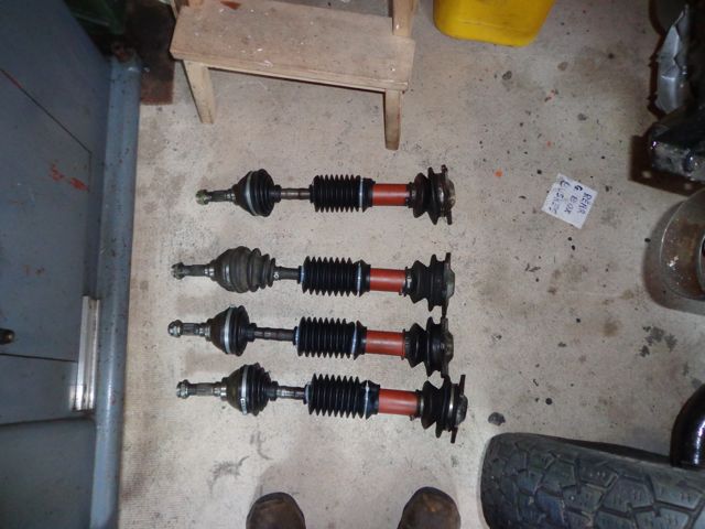

Drive Shafts finished.
Tool for fitting Gaiters, from vacuum cleaner, works with Middle, Inner and Outer.
(seen on another forum)

How do you explain all the grease on the tool to the misses? :lol:
May 24th, 2012, 7:33 am
Good old' dyson
May 24th, 2012, 7:35 am
Online
Posts: 2257
@How do you explain all the grease on the tool to the misses?
Do the vacuuming :o or Spare from ebay
@Good old' dyson
Admired the Guy anyway, now more so ;)
