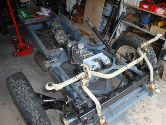

As the weather has been so mild, made/fitted some adapters to mount he spring cans.
Now I have a rolling chassis.
