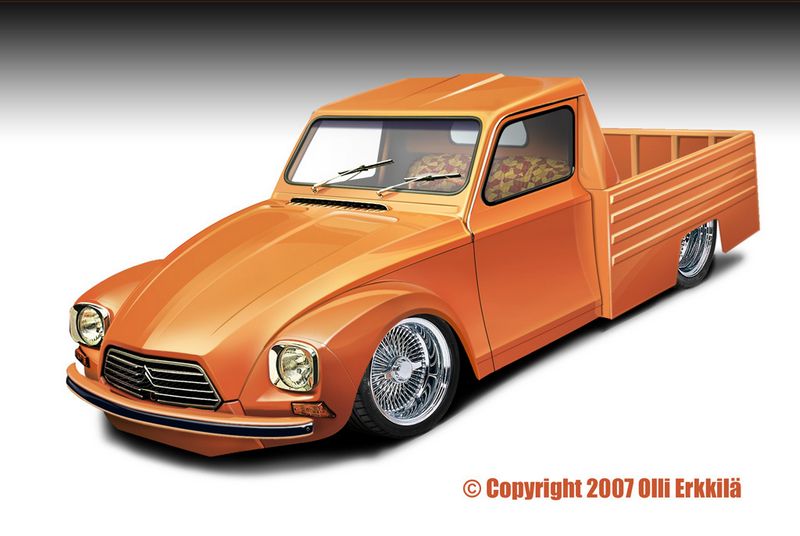

File comment: Some study of GERI
File comment: This is original picture from some fair in 1982
