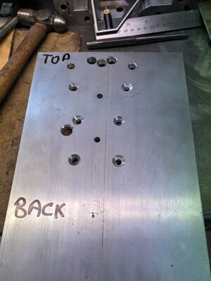

Back plate Number 2....Its a prototype/WIP/Bodge...

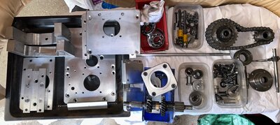

All the new parts made "in house" or modified Citroen parts.
Only the Tig welding and wire-cutting and bolts and bearings from suppliers/experts.
Waiting on the small (13 tooth) sprocket to be edm/wire-cut for the splines.
Now to carefully clean and assemble into a working transfer box.
The housing now in many parts, due to "bodgeing" but ended up with Triplex chain and the box now fits with +/- 20mm adjustment/clearance.
Just need a Mehari 4x4 style of chassis:)

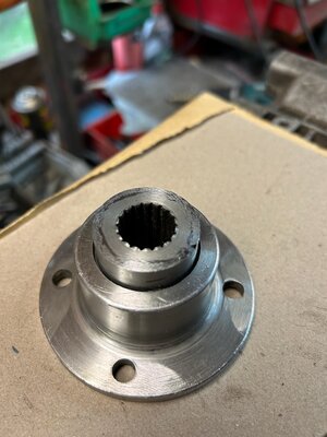

Getting spilnes cut, is now much harder:(
So a compromise....the drive flange (EN24T steel) welded to a turned down unused sprocket (EN8? steel).
Will they weld and will they survive?
