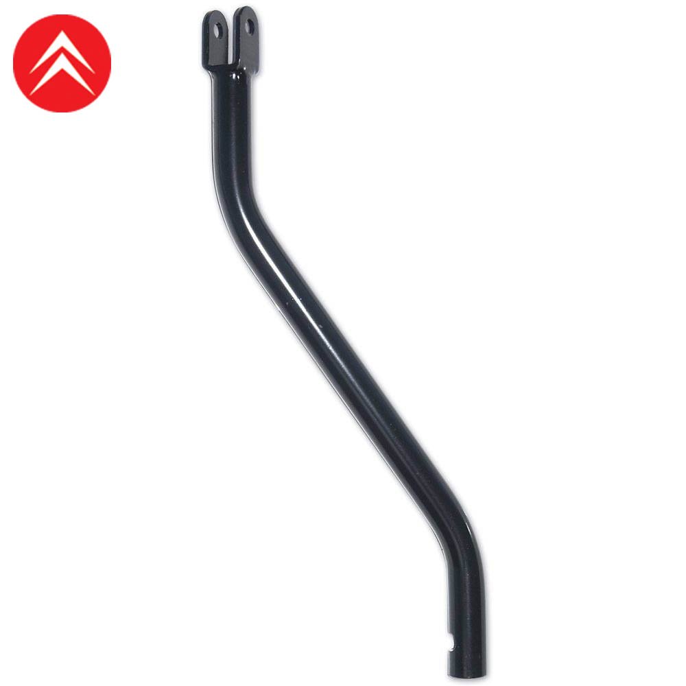

Bend that lever. A tight bend just over the uniball, and another over filler plug to the direction desired. Problem solved..?
July 6th, 2024, 1:57 pm
Feasable, also have a spare one of these

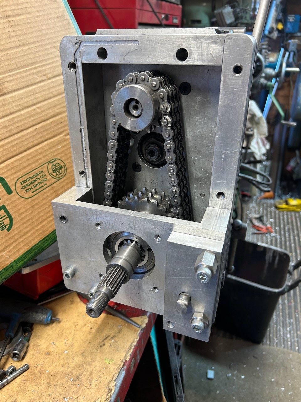

After some very careful measureing :) , I can fit a triplex chain and sprockets, whick only adds 5mm to the caseing depth. Had to redo the selector interlock....etc

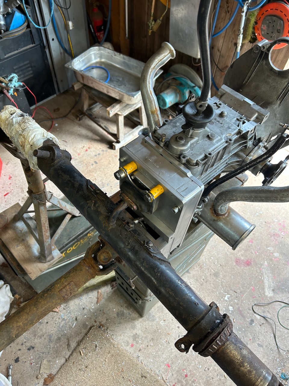

Trial fit with a a dummy chassis rail, its a very tight fit!!
However if I reduce the height by "20mm" not so tight.

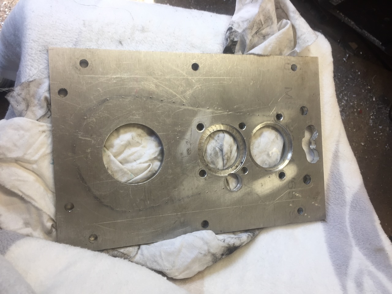

Means I have to make a new back plate:(
