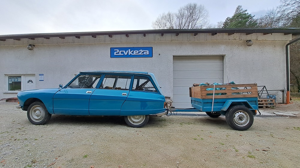

Everyday... trailer and my 1970 AMI. Can be loaded with trash or just loaded with stove wood for heating my workshop.
At this point, this is my only car ... everyday car...

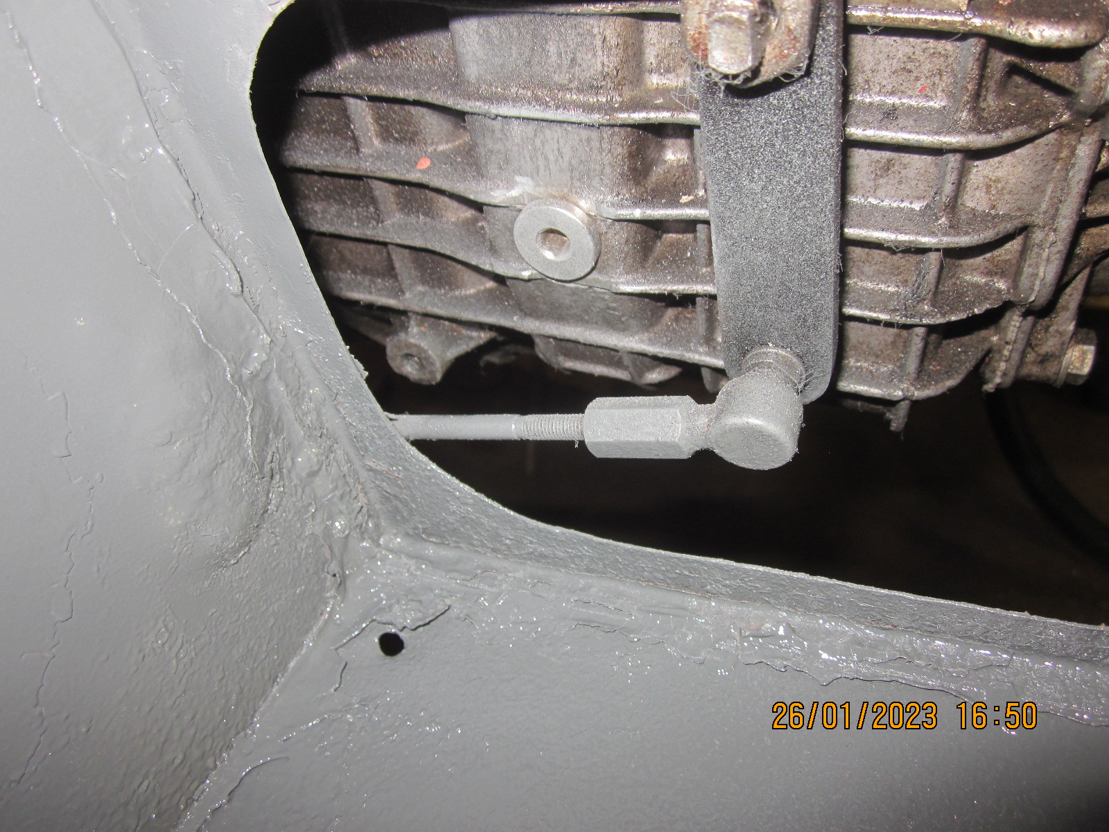

And a little more, new filler plug to rear diff, now it is possible to put oil in without removing the rear diff from Dyane...
Nice little plug, G1/4" -thread, plug has oil seal at lip. There was just enough room to drill the hole, making this was to make about five years or so...
