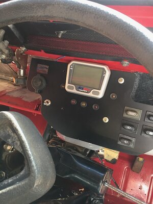

Some work on the Dash, used 2CV/GS switches, some with LED's to make the panel less cluttered and have used a Quad speedo extra functions and with wired speed sensor. no longer need a very long speedo cable from the rear diff!
Dash Board

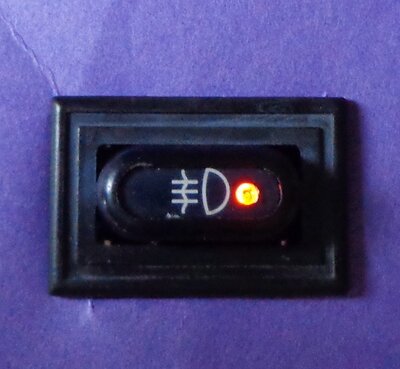

Rear Fog + LED

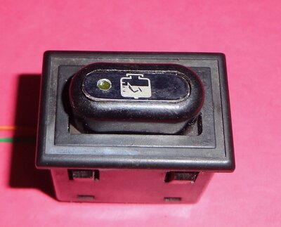

LHM Level/Test + LED
Wash is now a momentory push

That's amazing. Love the lights on the switches, so clever.

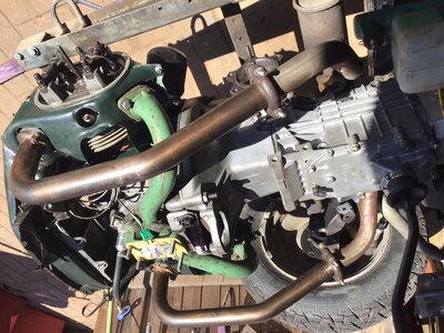

Engine and “clean” gearbox in place minus lots if bits, the hardest to fit is the clutch cable, which is in the post.

I thought you had fitted something like a lister stationary engine.... strange photo angle. ;-)
August 9th, 2022, 4:42 pm
Post Re: EPB Refurb
It does a bit, even funnier as my first job was at Lister’s.
Some times uploaded images are inverted :(

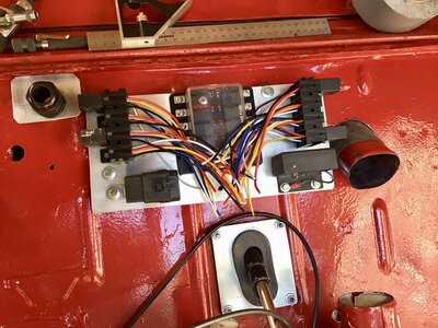

New wiring, fuses and relays.
Ps maybe over the top, but making things keeps me sane…

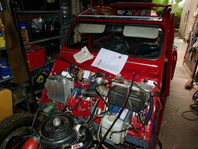

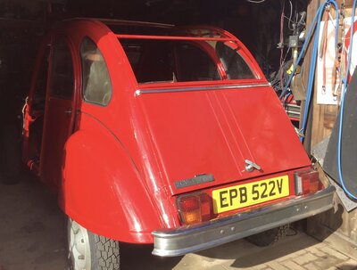

Rear end complete, waiting for a new hood, still a lot to do at the other end.
