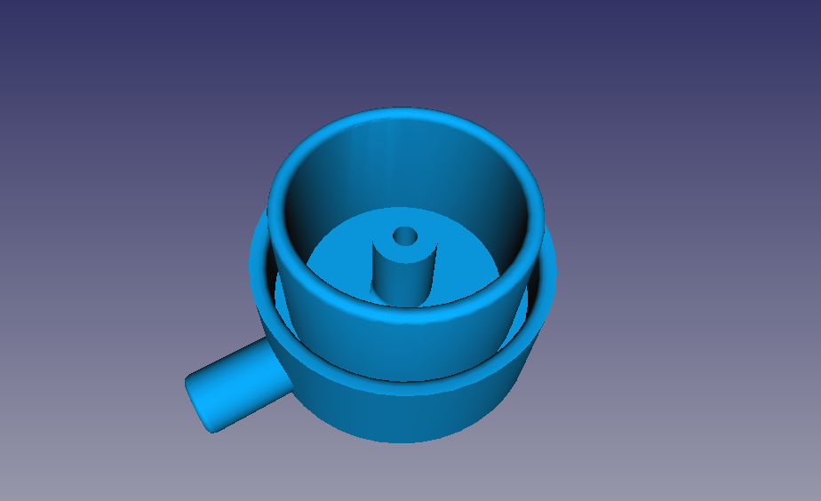

So, i tried it yesterday on my way to shop, and the cap came off the water reservoir, and dumped all the water. :D
So, designed a new cap for the reservoir.
The return line is in the cap. The addition of the inner collar, should stop the cap popping off whilst under load from the return pipe.
