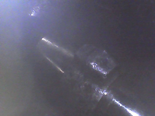

File comment: Should there be seen the top of the piston..?

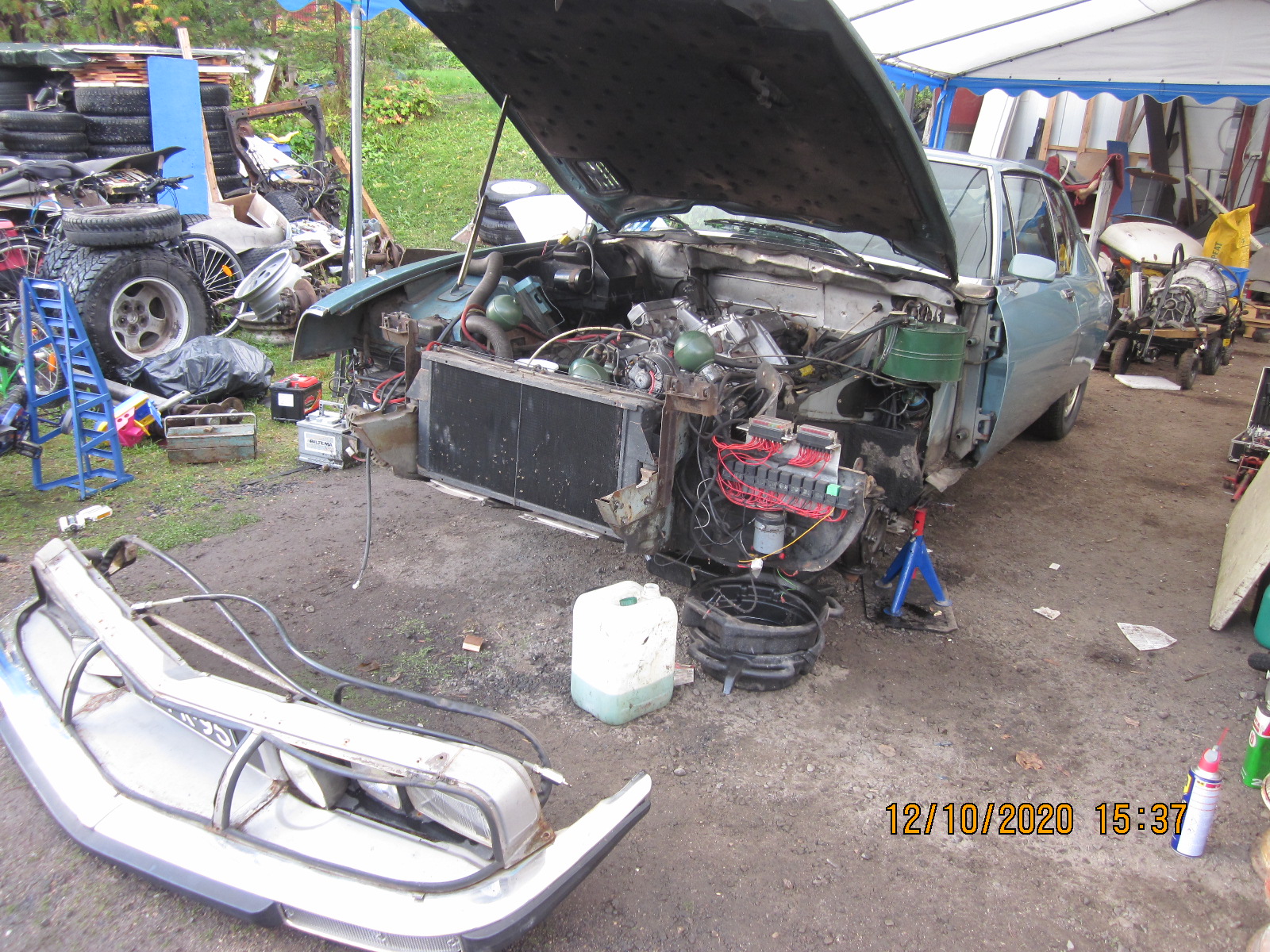

File comment: Pleased the front is as easy to dissamble as with Dyane...

^Yes, have had her 11 years. Bought with failed engine, driven at France last time before me in 1983. Very nice car, even too easy to handle in modern traffic, have compared to many quite new cars and nothing have beaten it. A real GT car, very comfortable to drive long trip, and too easy to drive too fast...
And simple, couple of hours today at garage, only exhaust to remove and engine is ready to lift-off. Then steering and C5 hydraulic pump back, and move her to "small garage", then there is enogh room to see what is inside the engine, is the engine repairable or not...

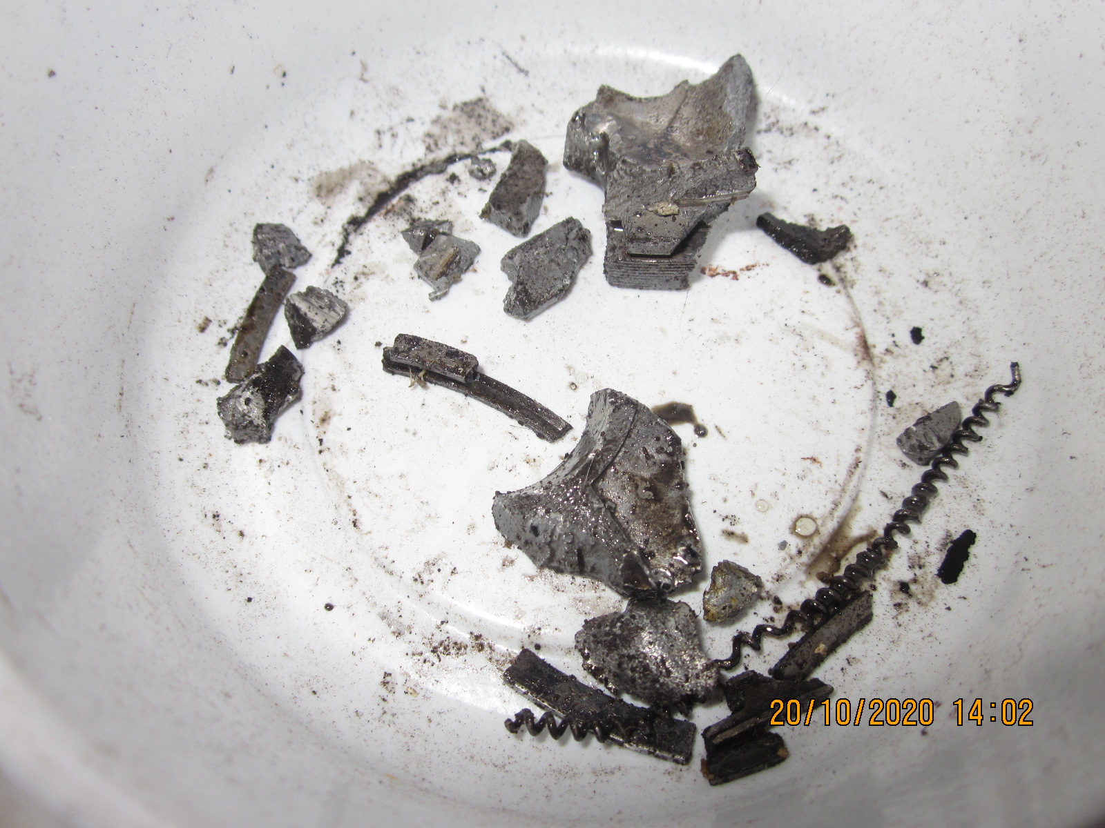

Took exhaust headers out, and then engine/gearbox out...
Those came out from exhaust. Piston and ring parts. Quite big pieces, wondering how much more is on silencer...

A nice mess....and this did pas the valves?
