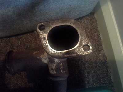

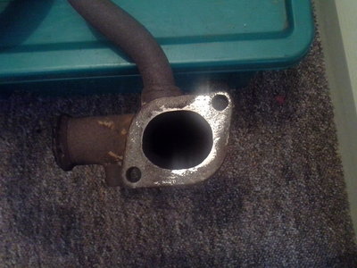

Exhaust started blowing again!
So I've dug out another manifold? This one has signs of previously blowing badly. The dull, pitted area shown in the images were covered in carbon.
I need to file it back so that if completely flat, with no signs of pitting, yet still retain the same angle, so that it meets the head correctly.
I'll prepare this manifold and fit it, then inspect the one that's on there currently, with a view to making that one good and refitting.
Just have to wait for the large file I've ordered to arrive. :D

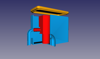

Been designing a water tank with submersible pump for the lpg system.
I suspect its going to be about as much use as a chocolate teapot, but its fun designing it. :lol:

Watertank? Are you going to build a steam car? ;-))
April 16th, 2020, 10:44 pm
Post Re: My Beduino
Watt!
