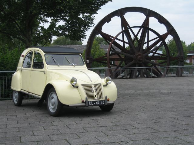

Ran into this picture of my car on the french Peugeot 505 site????
February 4th, 2019, 11:38 pm
Post Re: AZL 1957
That's nice :)
What is the big wheel in the background?
February 4th, 2019, 11:45 pm
Posts: 2288
Post Re: AZL 1957
It's a part from a huge compressor from a zinc factory if i am correct. It is at the Zinkhutterhof Museum in Stolberg (D).
