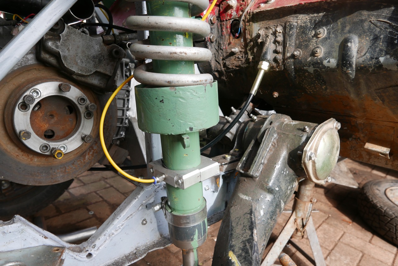

AK Track rod ends fitted, allows the track rod to fully clear the suspension arm on droop.
Waiting for the shorter AK track rod arms to arrive.

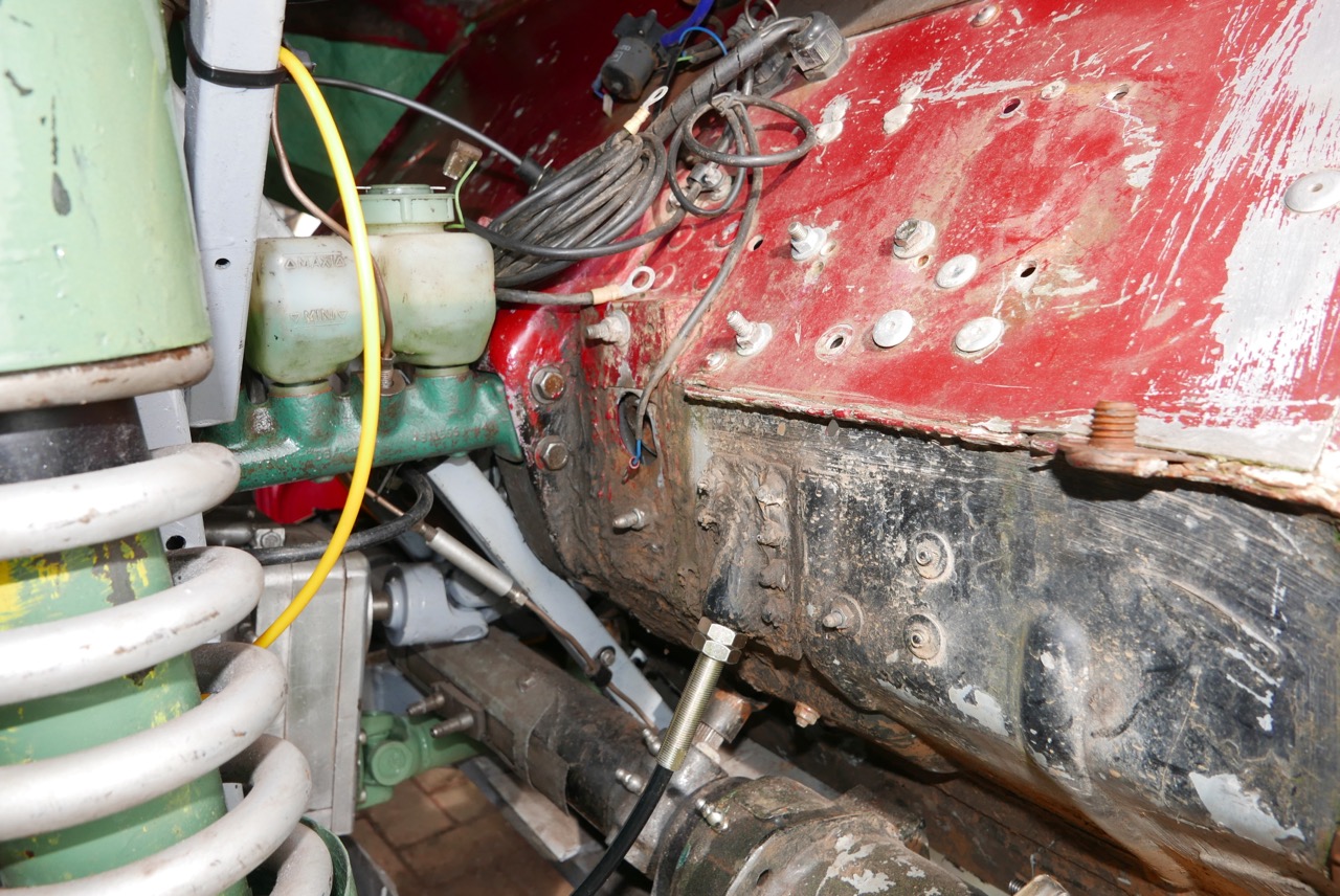

Fitted the pipe and new clamp for the low pressure LDS fluid return to the tank.
