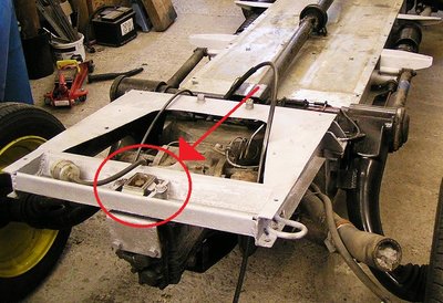

Posts: 161
Post Re: rear box rubber mounts ?
Seen in circle
October 5th, 2017, 8:26 pm
Pretty sure thats from a Peugeot, does it need replacing?.
On my version (2003) I have 2 mounts and they are fine, the front ones have been done a few times as they shear into two parts.
October 6th, 2017, 9:22 am
From LB
Rear single mount is probably from an AX gearbox top mount
later versions use Saxo gearbox top mount
October 10th, 2017, 9:33 pm
