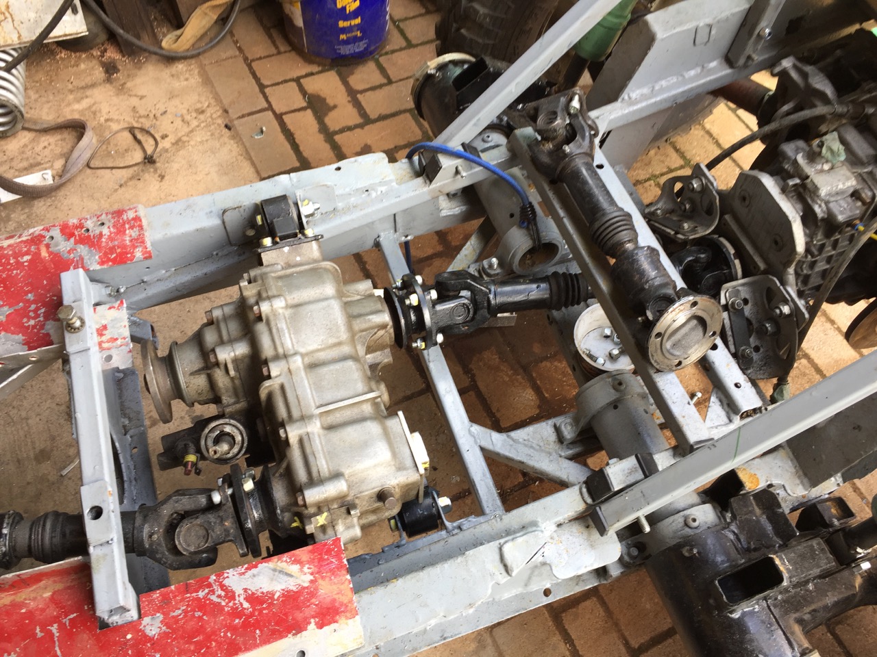

Bit of A Cock-Up.
These braces will "foul" the Toe-Board.
The body, was sitting 25mm above the chassis, (for a number of reasons).
I plan on sitting the body directly on the chassis as per standard! hence less room for the braces, problem is that there is very little room to fit them........

Looks like it will be best to cut into the toeboard then? Or will they also foul the pedal box?
The butterfly effect is working here! I luv it!
September 17th, 2017, 7:43 am
Hi Harley, Whats new with you?
Have cut them out, redone with steeper angle, they now touch the cross tube, the toe board already has a hole in the middle, so maybe a big hammer for the bits that touch.

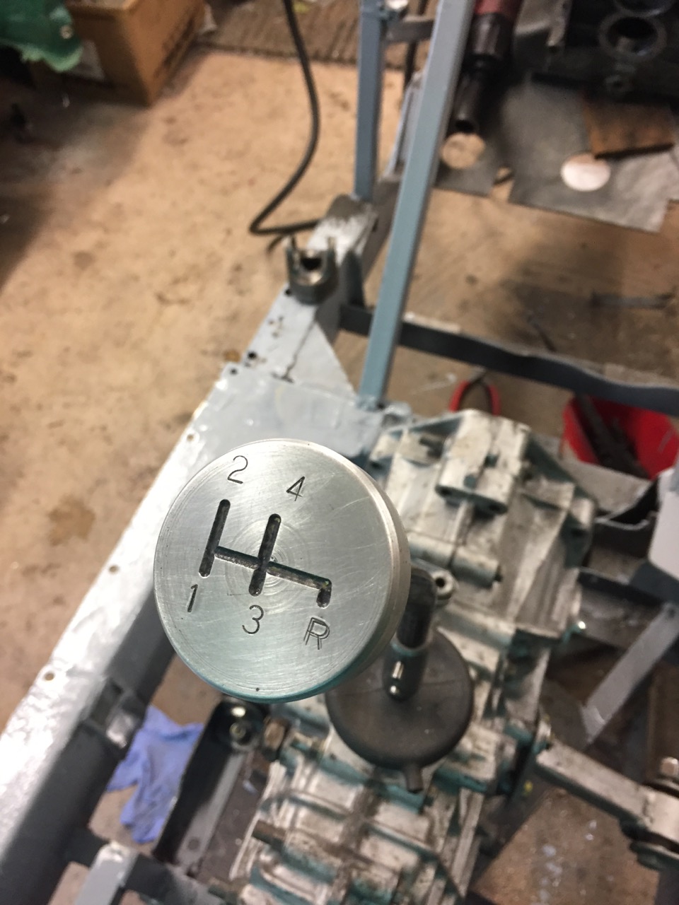

As the gearbox is now operated directly (ie no inverted link) had to make a new Gear Knob with the revised shift pattern.

Buttery Fly Moment. (Number > 29) .
The prop shafts angles are a compromise, tilted the T-box up a bit, now only one shaft with largish angles
Before
Now
The butterfly bit is the seat mount attachments will need to be modified
