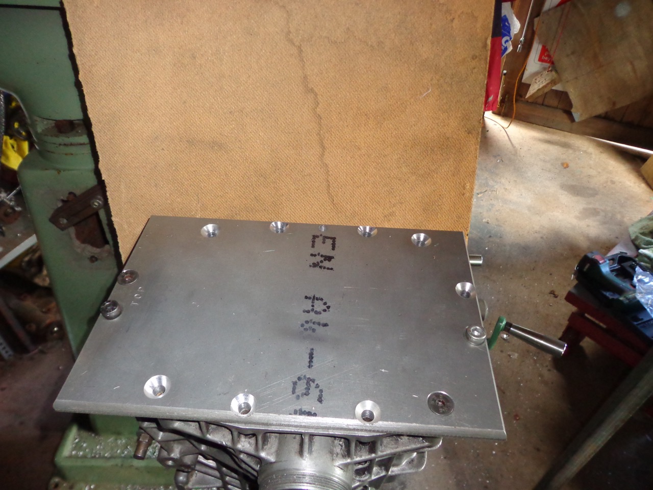

April 9th, 2016, 3:55 pm
Progress with the Stumpy diff.
Back Plate with mountings.
