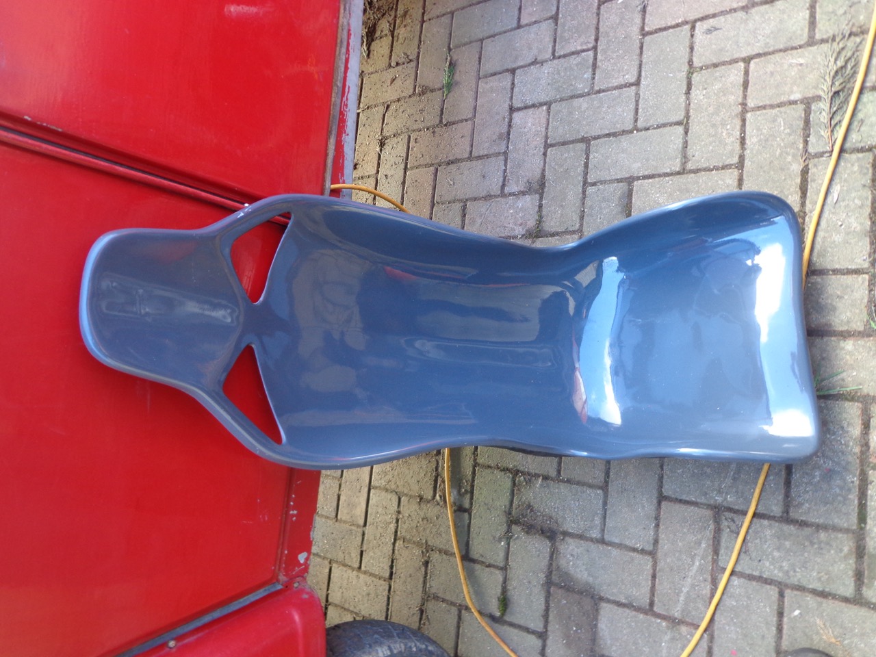

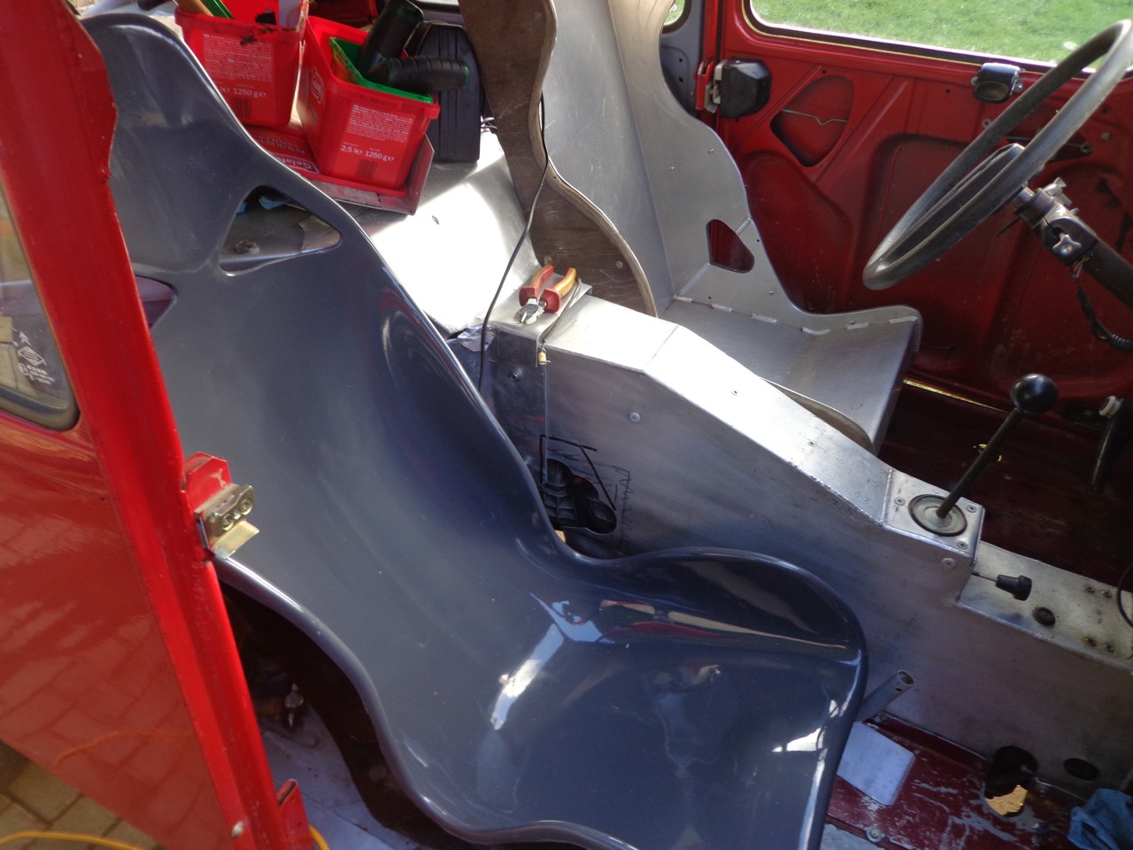

Purchased some GRPs seats.
Did a trial fit, will give just enough room for the seat belt stalk
Need to fabricate a new frame,still using the 2CV runners.
As they are Bum shaped, there will be a bit more comfort.
Shiny New Seat

Passenger Side

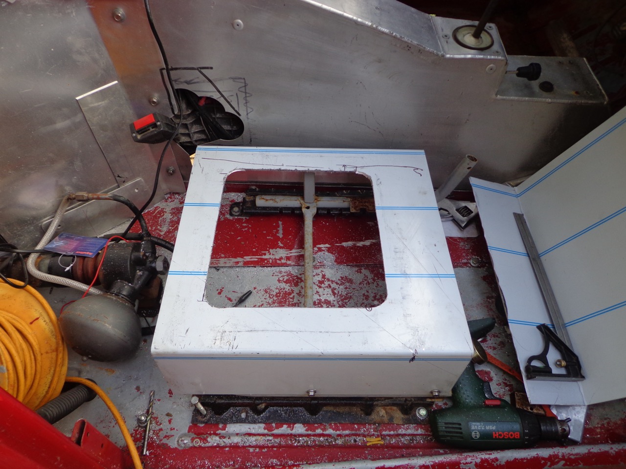

As the sun was out it was warm enough to make a bit of progress on the new seat mount.
3mm Aluminium bent up with a hole for the bottom of the GRP seat.
