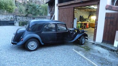

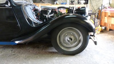

The car touched the ground today - first time since the engine was fitted.
I do like the hot rod, low rider look but I think this is a little low... don't you think :lol:

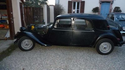

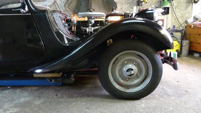

Put it up in the air again and noticed the adjusting bolt for the torsion bars had drooped. Put it back in place and lowered to the floor. Checked the heights (275mm from centre of torsion bar to ground) and it was still a little slow. Up again, another adjustment and it sits at the correct height now. I have not left much for the adjustment but looking at the access, it wouldn't be too hard to remove the adjusters and reposition them later.
A little bit of a polish and it comes up a treat for now. As I keep mentioning, the bodywork and paint if for next year ;)

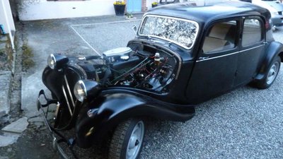

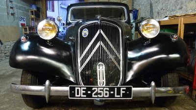

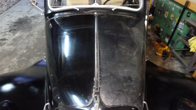

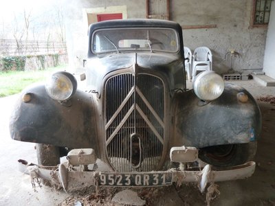

And now the front is looking like a Traction, bumper on.
Before
After

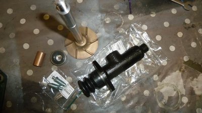

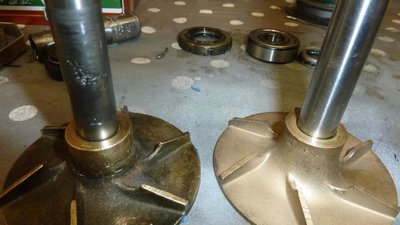

My new parts arrived today. The middle section of exhaust, new master cylinders, new spindle and turbine for the water pump, plus the seals and a couple of bleed nipples.
So on with the water pump first - the two spindles and turbine side by side. The new one is a lot better and is already attached to the spindle :D
Placed everything back on the engine and filled with coolant. Seems to be holding very well so far, not a spec of water coming out. Job Done :D
The exhaust went on OK, I placed the rear on axle stands and bolted it on. It is not the best fit for an exhaust but it is solid and is not knocking. I thing the silencer box needs to be a little wider to fit nicely. Another Job Done :D
But here is the Issue I have now - I put in the new Brake Master Cylinder - I bled each wheel in turn about 4 or 5 times. The pedal is slack, no resistance at all,as if there was a leak. I have checked and no leak - even the old master cylinder put the brakes on although it leaked form the front push rod.
But then the pedal goes solid - no movement at all. Then it releases and is spongy again with zero pressure i.e. zero brakes. I am using DOT 4 liquid. All the brake lines are new and as I said it worked perfectly the other day albeit the master cylinder leaked. So are there different types of master cylinder, could this be a wrong 'un?? This is very near the same as a 2CV set up.
