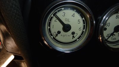

I have finished the night on a high and just had my oil pressure confirmed as sort of in spec that is great.
You could be right, it may have been pumping air last night and now after leaving it over night the oil has settled and bled itself.
