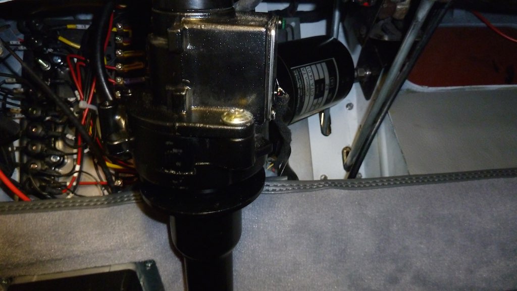

On with the steering. The instructions are not great when it comes to the photos as they are too small and dark. It would be nice to have a diagram but I worked it out in the end with a few emails back and forth to EZ Power Steering.
Got it bolted in and wired up
It actually sits higher than I thought and is very close to the gear selector bars. Should be fine though. Only two holes need to be drilled.

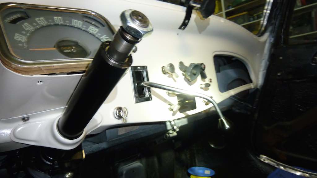

And finally I have a steering column back in the car. I tightened all the steering rack components and track rod ends and put the steering wheel on just to try it. Couldn't feel much difference but then I think I might need to put the tires on the ground for that :lol:

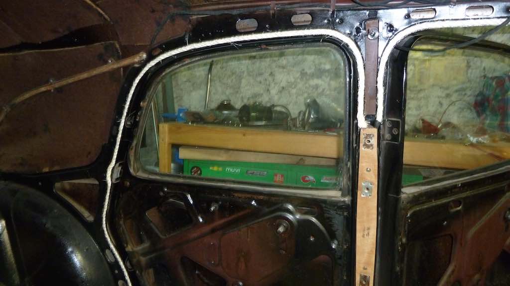

So on goes the trim rope which I have glued in place and tapped tightly with a hammer. Some of the difficult areas I have put a trim nail in place.

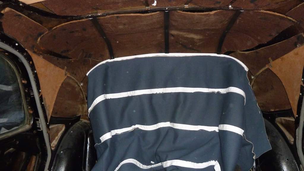

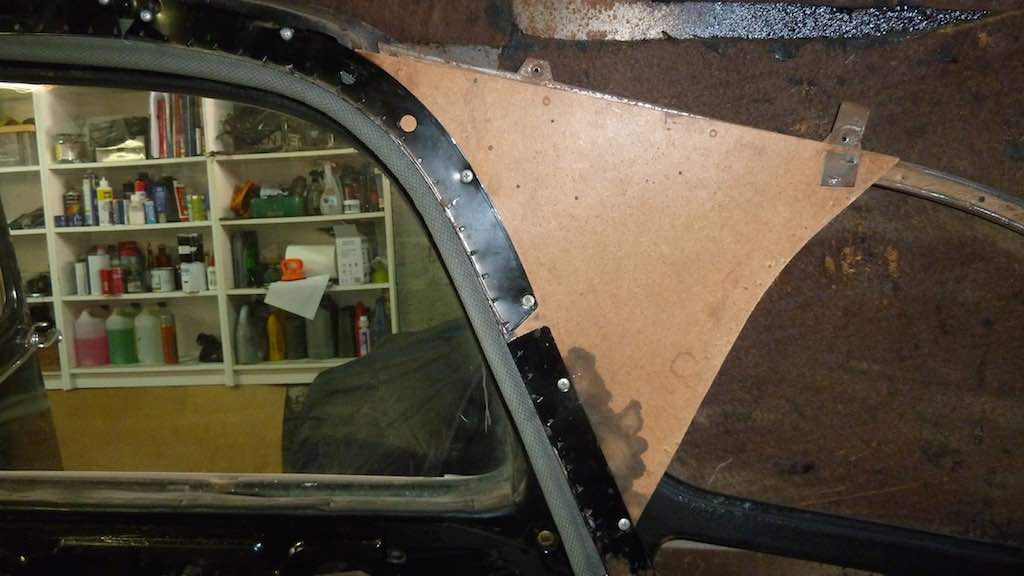

I put in the head liner beading and the old cardboard. I also tried the arm of the rear seat and the side panel just to make sure I knew where the headlining should finish.

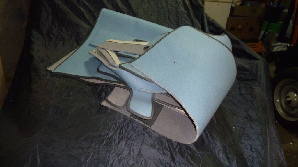

And now onto the headlining itself. I bought this from Renel a few months back and it was the cheapest out there. So I was wary of the quality but so far I am very impressed.
I had labelled all the rods so I just put them back in place and screwed them to the side walls.

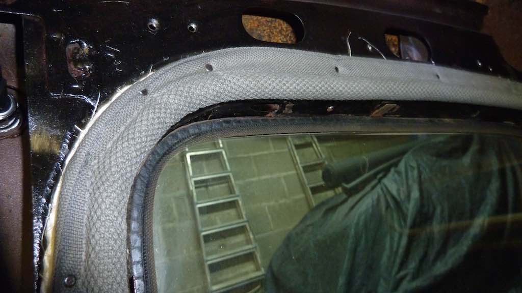

It has been another long day sitting in the car. The headlining was not as bad as I thought. It is quite a thick material so trying to stretch it was not so easy and I cam hoping it will hang nice over time. I did glue the loose roof sound proofing so hoping that will stay up there.
Inserting it under the side rails was the easiest part but the front window frame was a pain and I still don't think it is correct. It has been a year since I took it off and I am not sure exactly where it is supposed to sit. It just doesn't look right and was tight to fit. I will need to look at another car in detail and adjust as necessary.

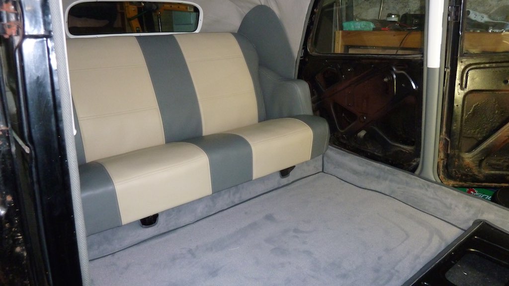

And as we collected our seats the other day, I could not resist putting in the rear to see what it looks like. I am very pleased with the look. I know it is not original but this car was never going to be restored to the original interior. We wanted a little comfort and something a bit different (not much but just a little)

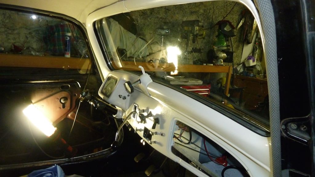

I put in the interior light too - at first it didn't work, then I turned the LED bulb around, then it did work. Then the switch didn't work. I took it out, cleaned the contacts and while doing so worked out the mechanics. So it pulls out and pops back turning on. And then pull it again to turn it off and then it pops back again. I was trying to keep it pulled out and thought it was broken. Citroen did complicate the simplest of things :lol:

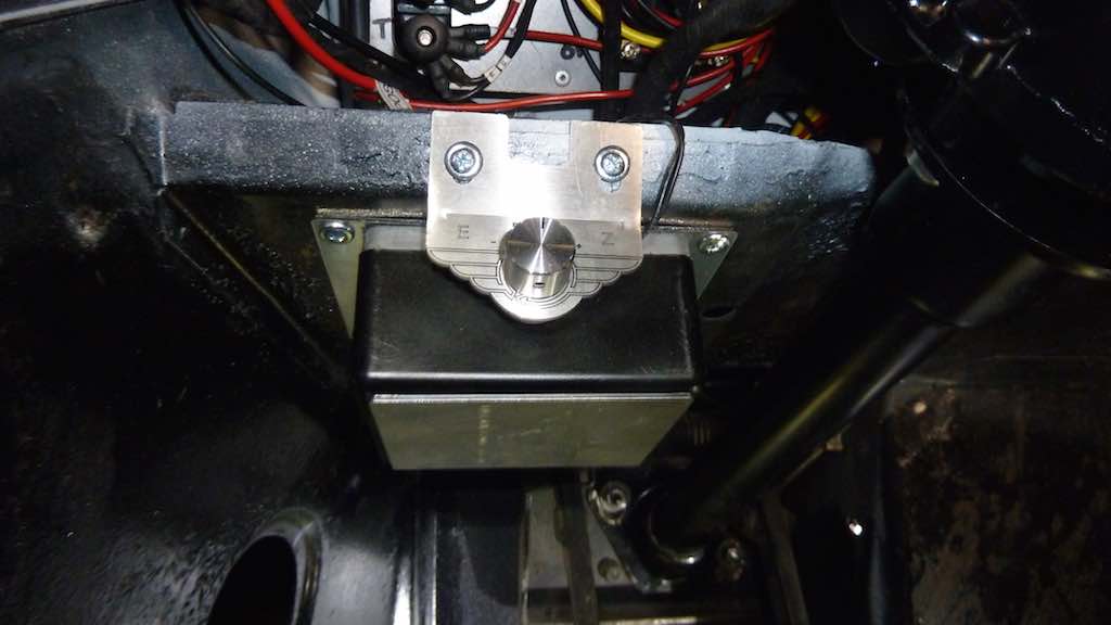

I then went onto finish the install of the EZ Electric Power Steering system. The motor is all tucked away up inside the dash and was a little confusing to begin with to find a decent fixing for it. But after a photo or two from their tech support, it all clicked into place.
The control box is too pretty to hide away so this is the only electrical item on show at the from of the car. Carpets fitted and even the original pedal covers cleaned up.

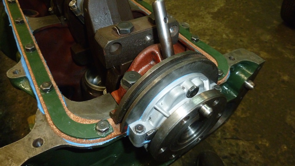

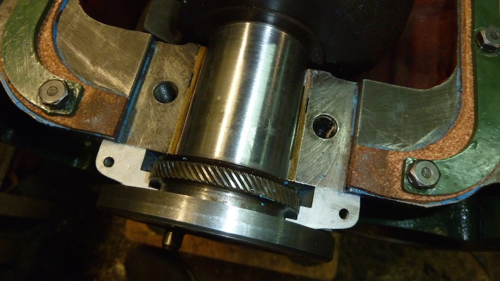

So I fitted the oil return baffle that I got from Jasu (all the way from Finland). I started to follow the correct procedure for this part (which was emailed to me from CTA in Sweden). I cut my shim from a coke can which happens to be 0.1mm thick. Wrapped it around the oil return on the crankshaft as stated. But then the bolts for this part do not fit behind the flywheel flange. It is impossible.
So back to the old procedure and follow a few more photos from an engine rebuild I found online. Fit the baffles first, then lower the crankshaft in and then fit the lower baffle to the main bearing cap and drop that on. Fit loosely and spin the crankshaft. Tighten the baffle halves and test the rotation of the crankshaft. It seems good now.
So the part I have been waiting for, for so long is finally on the engine.
So now I went on to the adjustment/checking of the crankshaft lateral tolerance.
I have followed the procedure for the adjustment of the lateral movement of the crankshaft and this is what I have.
Installed 3 thrust washers (shims) totalling around 0.23mm (these were already installed). With the main washer, timing pulley and nut tightened on and the crankshaft levered towards the timing case I have a gap of 0.5mm between the main bearing and the main washer. This is way beyond the 0.1 to 0.15mm that is in the book.
What can I do to rectify this? Never done this before :shock:
I am assuming this is a standard procedure for any engine.
