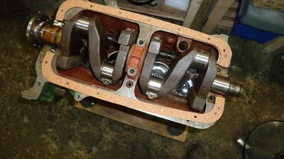

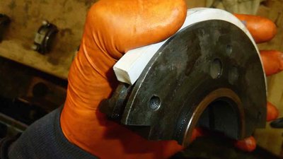

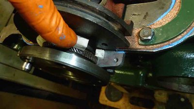

So when I come to put in the crank seal assembly the rubber seal is a little short. Now is it supposed to be this length and I need to stretch it or is it just too short. I was going to close it together and superglue the ends to make a complete rubber ring. I have sent a message to CAS in the Netherlands to find out.

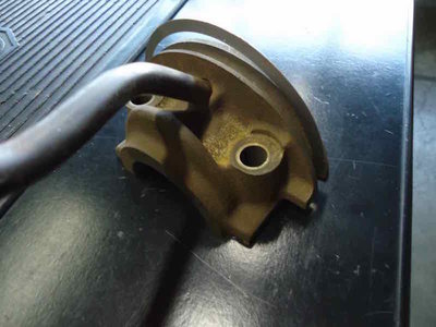

This is the timing chain end and this will not meat the crankcase surface at all.
December 19th, 2014, 4:49 pm
This is so annoying - I ordered the gasket kit thinking it would have ALL the gaskets in it. But no, there are some extras.
So firstly I used the rubber seal in the wrong place (I can see that now), this is to go between the bearing cap and the sump. It will need stretching :o But there is a half moon of steel that is required to secure this in place.... who knew?? :?

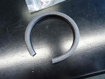

And for the crank seal I need a length of special cord...... aaaaargh :evil: :evil:
It is now in the post from Holland along with a carb gasket kit and a feul pump gasket kit and also the carb heat shield..... may as well profit from a new order of parts :D

That special cord looks like wood burner stove door seal. You can buy this in Brico Marche in different sizes

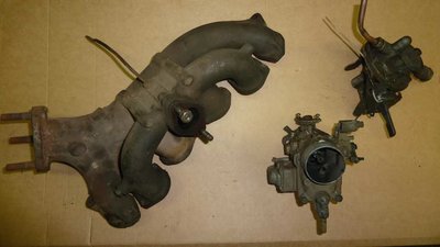

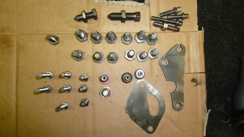

So on with some more cleaning. The manifolds, Carb and fuel pump.
The Carb I will have to strip again when the refurb kit arrives but I thought I had better put it back together before I forgot where all the pieces got to.

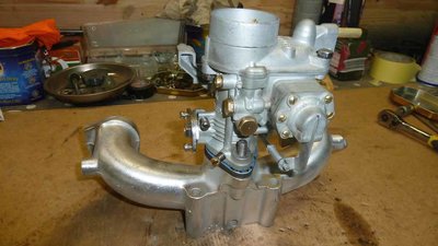

And the inlet manifold came up a treat - no paint required.
Then onto some of the miscallaneous bits and bobs. This Pyrenean mud seems to have preserved the metal pretty well.

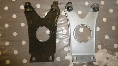

which method did you use to create this excellent result ??
December 27th, 2014, 1:18 am
Pure magic... ;)
December 27th, 2014, 2:42 am

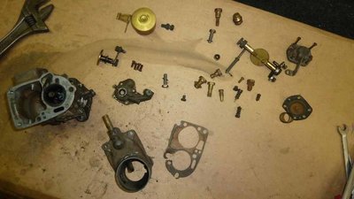

I stripped the carb all down first.
Then some time in the microsablage cabinet (fine sand blaster). This is not good on greasy things so a full degrease first and rub down, scraping any lumps out of the groves and corners first. Also my cabinet is getting damp now its winter so the sand is clogging up the pistol..... pain :(
Then, in the case of the manifold I polished it up on the wire wheel which takes away the dull finish the sand blasting gives.
For the carb I flushed it all out with degreaser and fuel to get any grains out. Then blew it through with some compressed air.
The individual brass fittings I wire wheeled, but it was not necessary as the carb refurb kit had come with absolutely every part - last kit I got had a gasket and a main jet replacement. This one from CAS came with every new removable piece including the brass float for €20. Will post of the photos when I rebuild it again.
