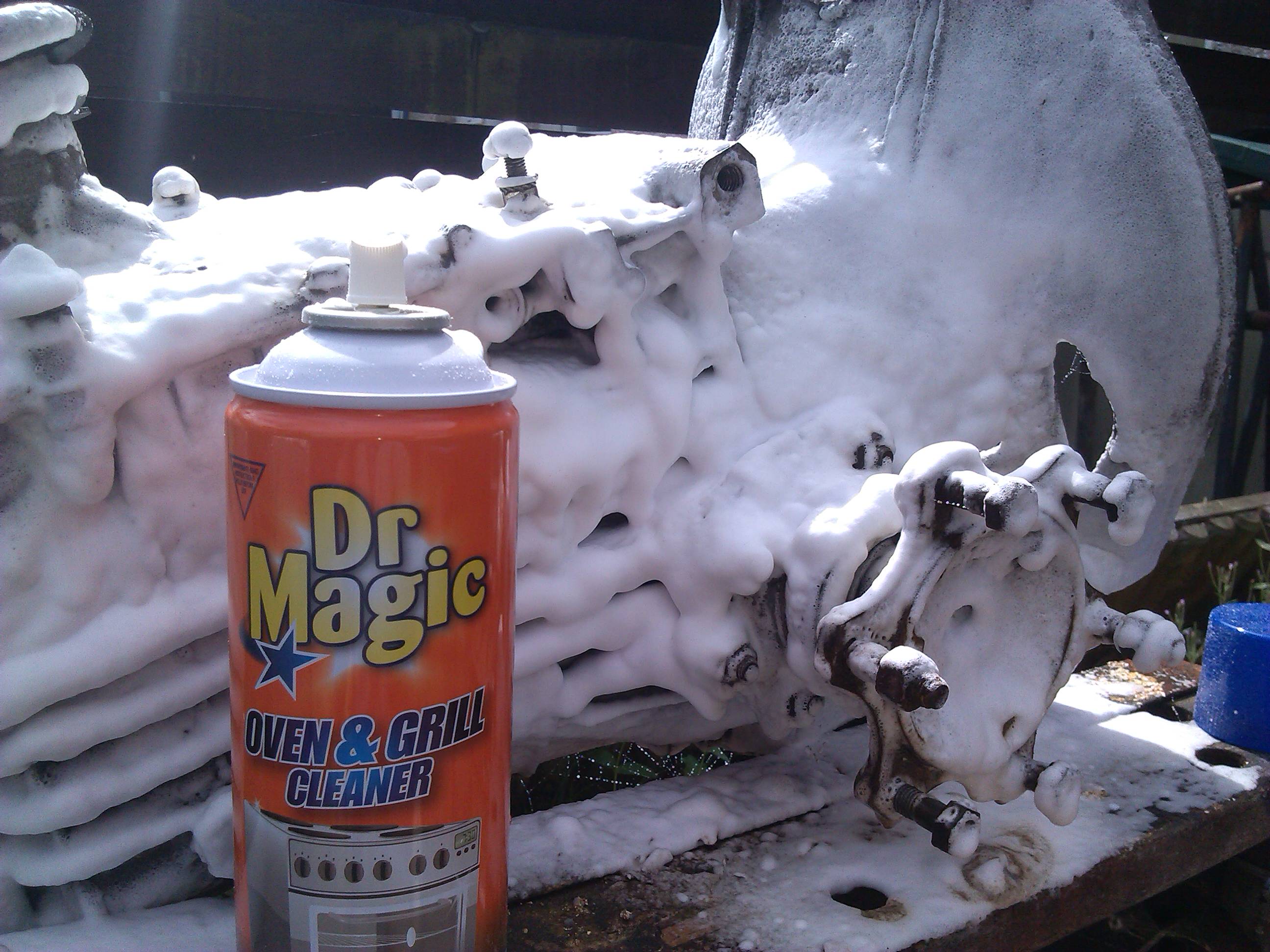

DrMagic oven cleaner from your ££ shop, B&M or the 99p bit in Asda brings engine cases up a treat as well as de-coking the heads ....best bit is it doesnt seem to eat the ally, rinse it off with hot water and then spray with wd40 and make sure its dry or itll end up furrier than those heads.
put the valves in a drill ( either pillar or just a B&D in the vice) and spin them up and de coke with a bit of hack saw and then either emery or steel wool to polish them right up.

Thanks Sean, I'll go down the cheapy shop tomorrow and get a load of that stuff. I have to get my vice restored before I do too much, reckon I'm going to powdercoat it white.
Reckon it's ok if any water and shit gets into the crankcase? I'm sure if I flush it out with summat it'll be ok, what's the worst that'll happen?
I'm going to make some new oil feed pipes like Sean does, and refurb the breather with a kit that Subarupete gave me. I'm bang into doing stuff for cheaps where I can. I'll do a how-to as and when I get around to it.
December 11th, 2014, 7:57 pm
I couldn't find Dr Magic but I bought some other cheapo pound shop oven cleaner, It's not too bad but I'm still going to have to pressure wash the engine to get most of the crap off. I reckon there's good money waiting out there for the person who invents a spray on engine cleaner that makes all the accumulated shite fall off and leaves the engine shiny and sparkling with absolutely no effort at all.

Always found "Gunk" does a pretty good job of getting crap off if put on when engine is warm and then left a bit and given a good water spray afterwards.....
December 12th, 2014, 9:31 pm
No Asda near by :| soften the real claggy bits with brake cleaner first
