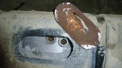

I have cut out the rusty area which is the sump part (slight bowl in the bottom of the tank with a drain plug)
The tank looks good inside, zero rust other than slight surface around where I have cut.
Any ideas on how to form a new sump and how would I put a drain plug back in - OR is any of that necessary, could I just weld a flat patch over the hole. The tank is easy to get to and to remove if ever I needed to work on it.

Weld your patch larger than the hole, there will be small sump.
Else get a leather bag+silver sand and hammer the steel to a sump shape

it's easy to form a plate like that.
Heart surgery is easy if you are a surgeon :lol:
Take me through it step by step ;)
Do these bulkhead drain plugs exist anywhere, can they just be fitted by screwing them through the hole (like a plumbing fitment)

Find a hollow item that is easier to form. A piece of wood with this form chisseled out works nice.

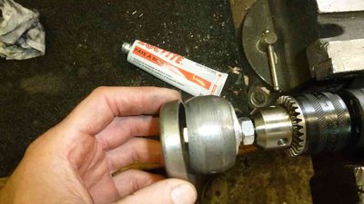

I received some more info on the bottom ball joint. Originally Citroen put in a 0.05mm shim between the upper bearing race and the middle spacer. This was to allow adjustment later on when the ball joint wore a little and the shim could be removed. Both of mine still had the shim installed. But even with that removed there is not enough adjustment.
So I was advised to remove the middle spacer which acts as a conduit for the greasing and discard it. (new ball joints do not come with the inner ring spacer).
I first tried to smooth off the ball and the bearing race a little more using valve cutting paste and sticking the ball in the drill. It seems to have worked a treat.

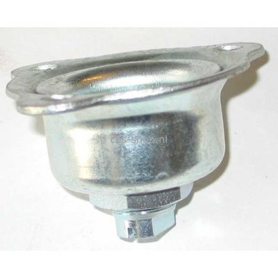

I then installed it without the middle ring spacer and voila - I have a much better fitting lower ball joint. But to make it better and easier to adjust (instead of inserting different size shims) I have ordered an after market adjuster cap to replace the existing ones.
This should do the trick and even without it now it is nice and smooth with very little play now I have squirted the grease in there. :D :D
