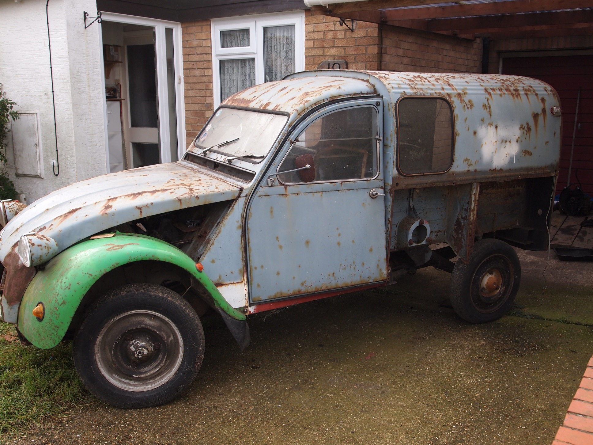

Right. I have officially started on the AZUwithnoname or more importantly @ the mo, with no identity. Matt Concannon has been & examined it for the purposes of producing an age certificate so I can start on getting paperwork. The only document I have (from the Oxford Abatoire) is a bill of sale which on examination proves to have the wrong registration number on it... This is par as the French documents he provided for it were for an entirely different vehicle.
So I have a. started seriously looking over it & pokeing holes in it - should be some pix here I hope.
I took the screen out to find what horrors were under the rubber but it was good! Attacking this corner with a screw driver produced a small hole but the rest is fine :o
And the underside looks straight & possibly sound, though the chassis internals are giving a starved horse look which may not be a wholey good sign...

Ok, the pix came out in the wrong order but I hope they are self explanatory! The worst I can see is the bulkhead/parcel shelf, those panels are a horrendous price so I will have a go @ making or repairing them first, cab floor is just a panel & I hope most of the rest of the shell will be patching... Just the chassis & mechanicals then - piece of cake! :lol:

That's the one that sat for years in a field at the lockup of ex-forum member "AZU250", isn't it?
If so, it's a 1967, according to the info he gave me when I looked at it in 2010, with a view to buying.

I do believe that to be the case! It has suffered from a lot of sitting around being soggy but I'm on it now ;)

As I remember it, there were some staggeringly solid and in-tact parts to that van... but also some extremely sieve-like rusty bits. It scared me off, but I mourned not buying it for weeks! I really coveted it, and look forward to seeing you get it back up to scratch! Good luck. It'll be worth it!
Oh, and here are some pics I took of your van when I was lusting over it!!

I nearly went for that when it looked much like in those pictures. Maybe I should have, although it doesn't seem to have done very well in the intervening years. Hope to see it puttering round in the near future.

Crackin' pix Smiffy! Thanks :D
Interestingly the middle body crossmember on the right (supports rear of petrol tank) appears straight in the photie - it's now bent backwards about 15mm @ it's outer end. The bulkhead already looks like it had gone thru in places...
