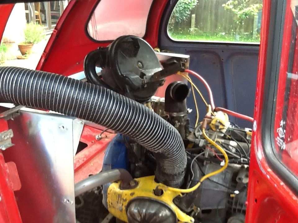

With the engine cover + sound proof, the car is much quieter, however the tunnel gets to hot to lean on.
All the air recirculates even though the engine compartment has no floor.
Got some large pipe to go from heat exchanger to the quarter lights.
Pipe.
Outlet point.
October 7th, 2014, 4:40 pm
Made the Square to round adaptors on the engine covers, connected up the pipes.
Run the engine and the volume of hot air shows how efficient the 2CV fan is.
But the starter motor just gave up the :(

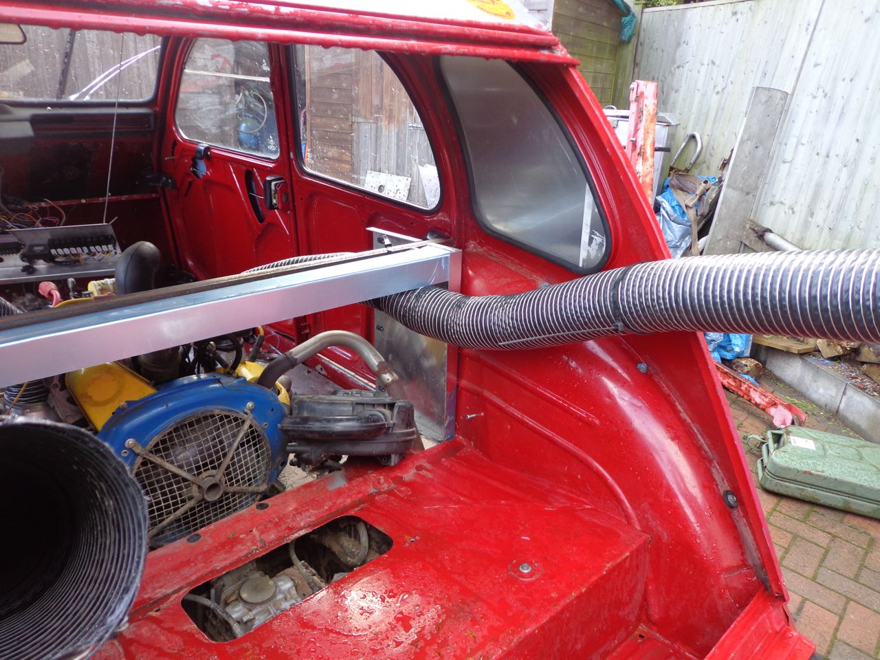

October 10th, 2014, 5:58 pm
Got the pipes welded to the quarter light panels.
Fitted the pipes.
The room for the air cleaner was now to small so I fitted it upside down on the cross bar.
