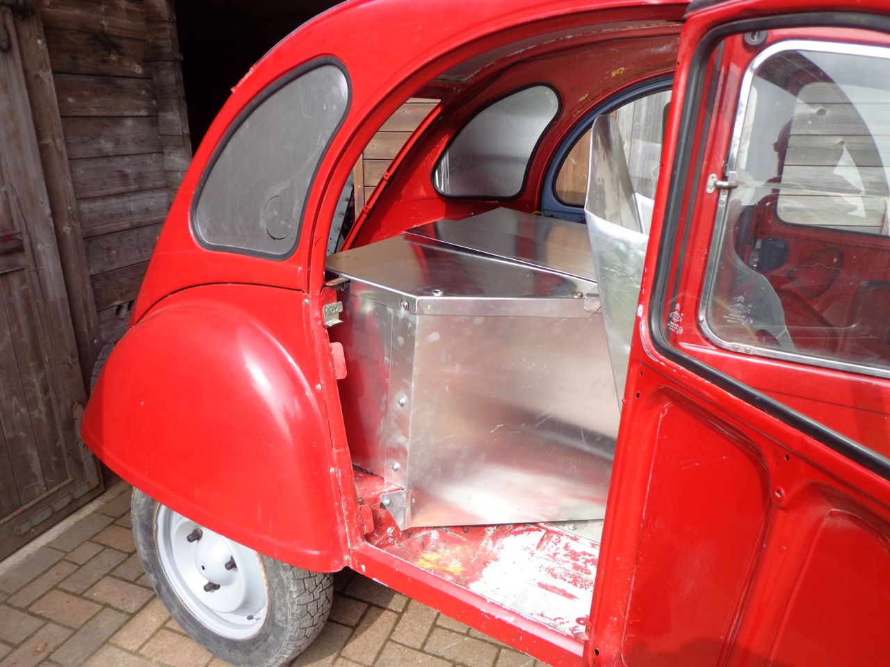

Made cover for Engine ++ sound insulation.
Ready to go to France...

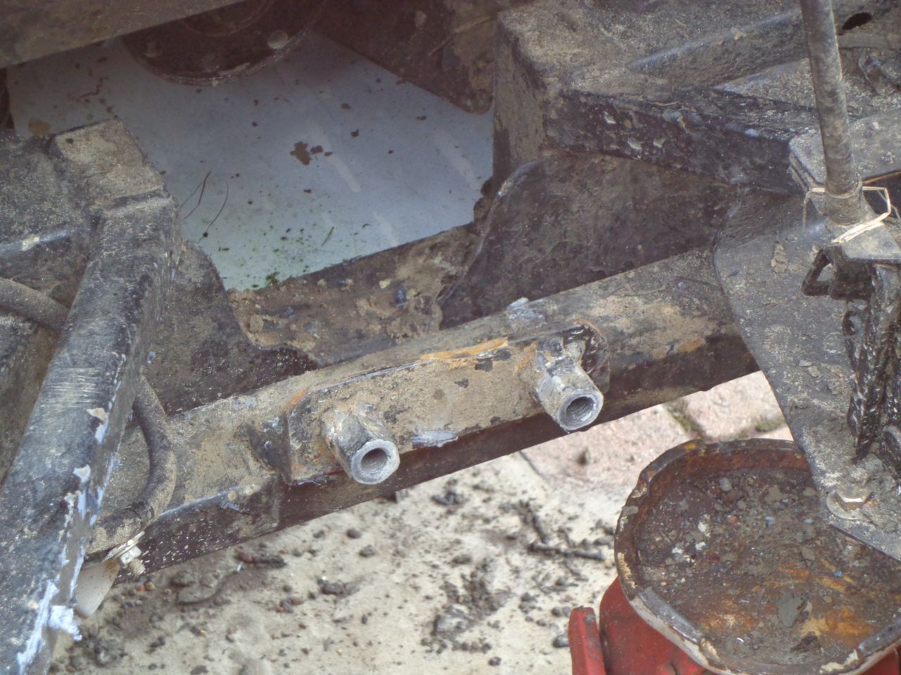

Broken mountings for the front diff..

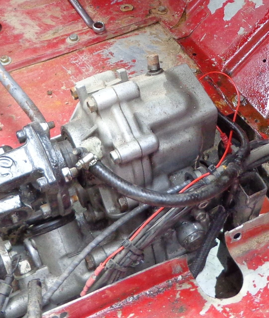

Other Bits damaged.
Oil feed to TBox leaking, new pipes that are really oil proof required.
Bent Gearbox mounting (5mm angle).

You did a great job bending all this stuff...... did you do some jumpes on full power??
September 24th, 2014, 5:51 pm
Some steep climbs with rocks, to Fast as per usual.
But looking at the welds, they are bad,
I did them with last of the Gas and the end of the wire reel not feeding properly.

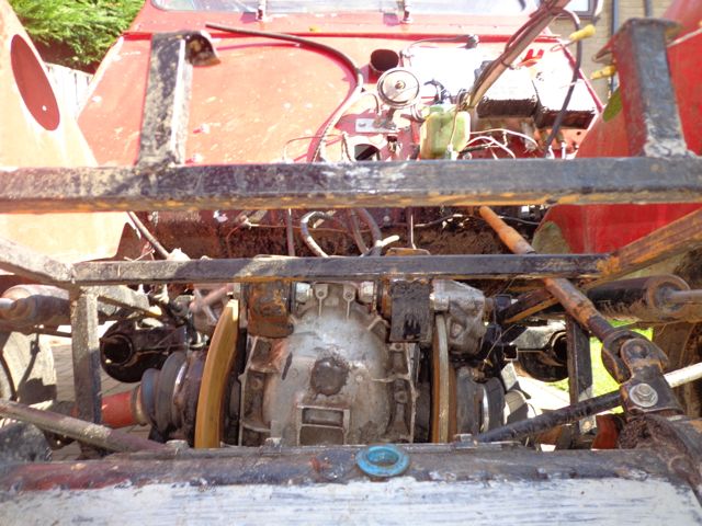

Plan to mount the front box with four mounts as it seems to get more movement/stress then the rear.
September 24th, 2014, 6:29 pm
Strange I would bet the rear would have more stress than the front.....
September 24th, 2014, 7:01 pm
The current job is to build a new Gearbox mount in 3mm steel and Thick wall tube, as 2mm steel and exhaust tube are not up to it...

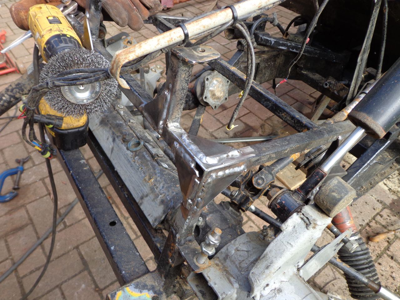

After some more "Espionage" ;) in France, have added some Gussets

Revised Front Diff Mounting...
October 4th, 2014, 1:57 pm
Diff now refitted..
