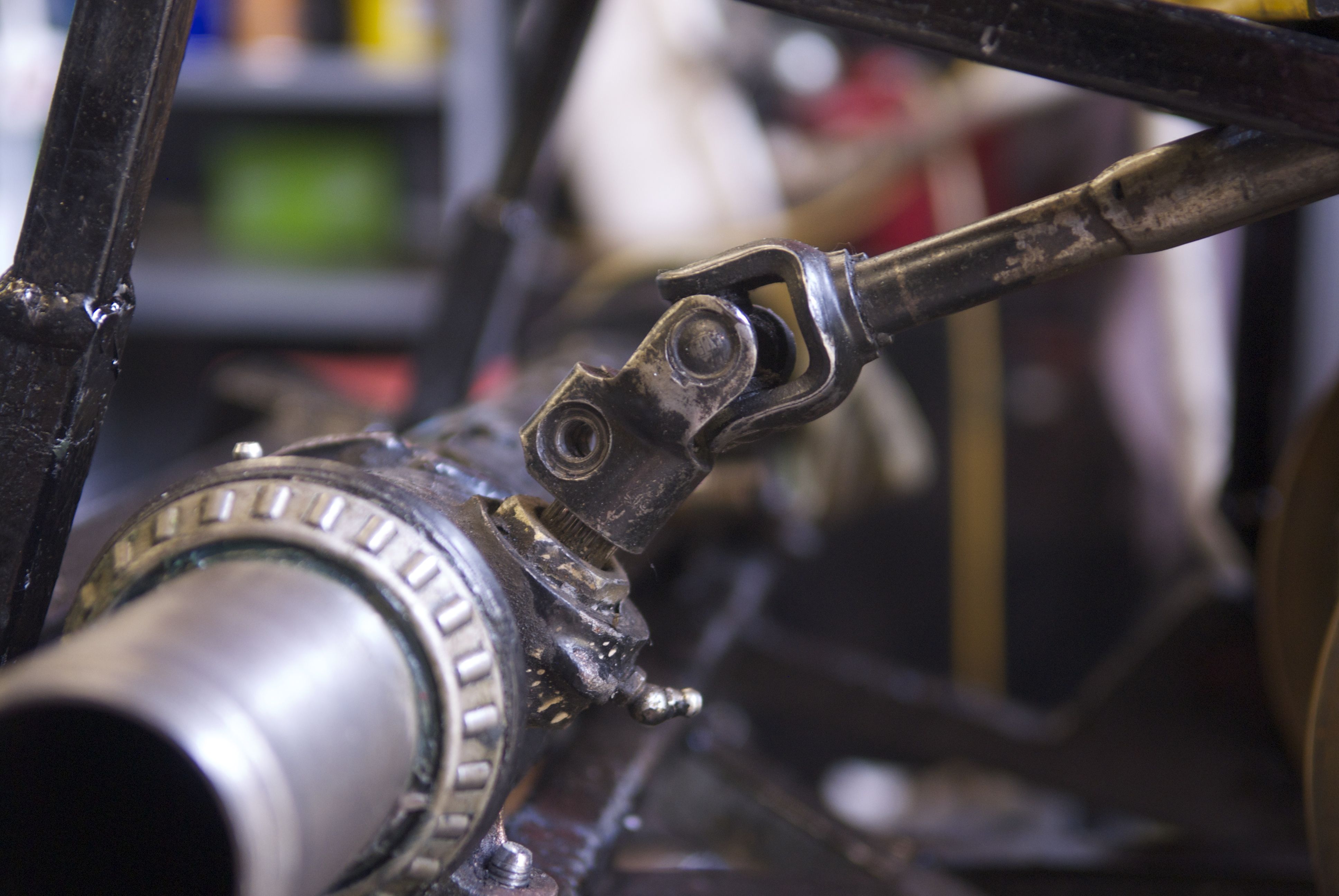

Progress (Two forward, One back).
Have rotated the steering rack (again!) such that its unlikely to collide with the steering rods.
The result being that the cv-joint angle is on its limits.
So I have to move the steering column up some more.
The steering column will now pass through the joint of the Toe board and Bulkhead :cry: .
Some patching of the thin suff to be done...
