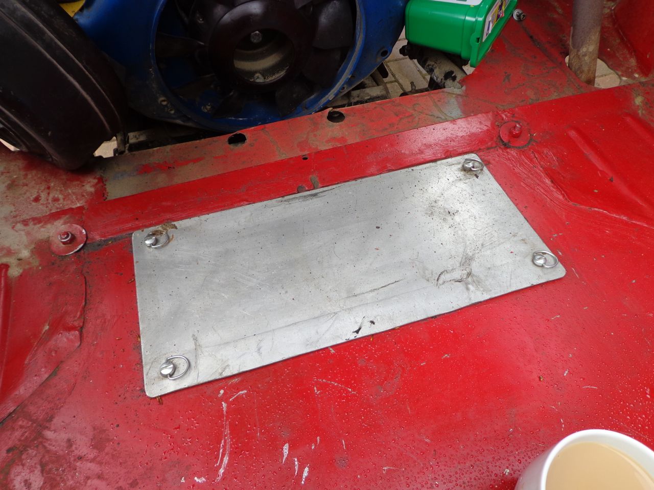

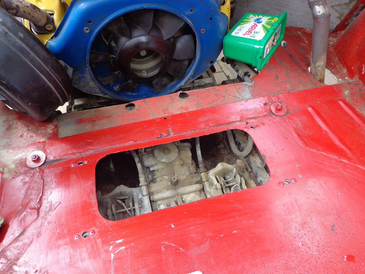

DZUS fastners are for body panels and the like.
Measure panel carefully and select the correct length, else they don't fix properly.
too long by 1mm hence the washer...
Rivet in clips are easy to fix http://www.ebay.co.uk/itm/GENUINE-Dzus- ... 53de05239a
See pics
