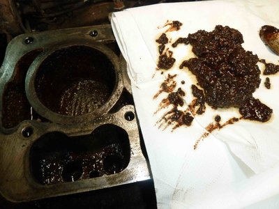

Quick update - managed to get it into the garage today as my 4L is "stuck" at the carrosserie (I was a little naive to think I would get it back within 3 months).
So I took the head off to see what was stopping the engine from turning over. I think I found the problem :lol:

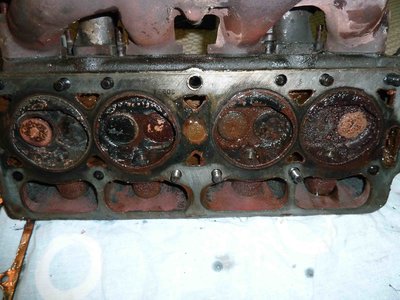

The piston barrels were full of my loosening concoction so after withdrawing it with my giant syringe I wiped them as clean as possible. Piston 4 is chipped and broken a little. Piston 1 is chipped, broken and the barrel is rusted out.

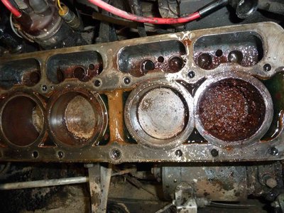

I scooped out all the rust - not good. Looks like I will be having new everything in this engine.

Post Re: Anyone know about Tractions?
That is the trouble with ancient cars, you never know what problem you will discover next.
But on the other hand : It is exiting ;)
Goodluck !
