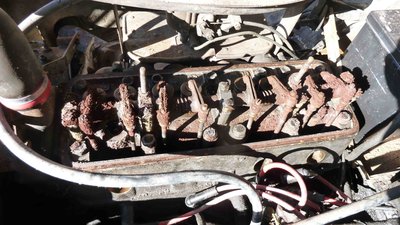

Took the rocker cover off today (it was sunny outside). It looks a little furry :D
Squirted a mixture of diesel/Oil into the cylinders and onto of the valves, just to see if anything budges.
All the documents have had to go off to the big city in Toulouse as the car is a little old and not in the modern computer system. So hoping when it comes back it will all be OK. Then I take it on the trailer to the MOT centre and get a total fail BUT a certificate that is valid for 1 month - I then will register it in my name :? that is the plan... will have to see if it works.

Might not be what you want to hear, but given the amount of rust which is visible on that rocker gear, I'd advise against making any attempt to turn that engine, never mind start it.
The last thing you'd want to do is destroy the engine's bearings and oil feed system by feeding them with engine oil laced with powdered rust... :(
