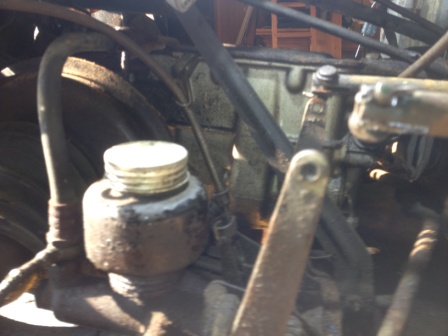

the clutch mechanism: cable to hydraulic master cylinder, pipe to front and back slaves

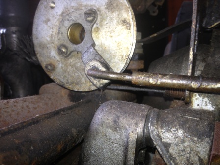

gear shift rods
