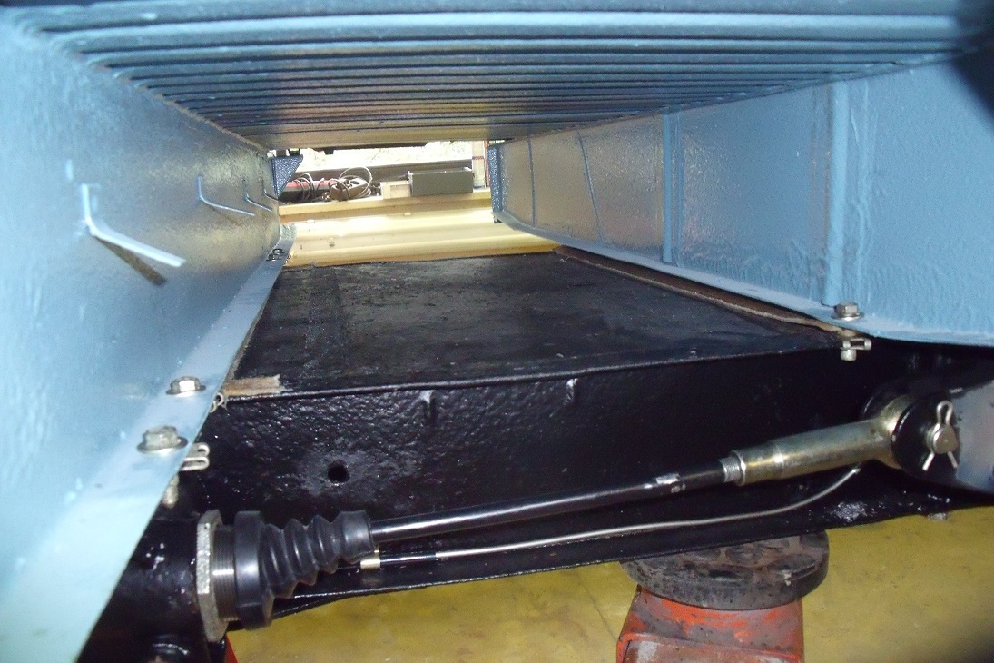

It is been sometime since this AK is on the road again... Here is some pictures from assembling it ...
www.2cvkeza.com
January 15th, 2014, 9:48 am
Posts: 603
Location: Slovenia
Post Re: AK 400
www.2cvkeza.com
January 15th, 2014, 9:49 am
Posts: 603
Location: Slovenia

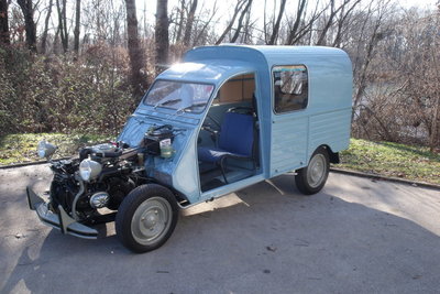

And a latest picture of AK on some local meeting in Slovenia
That is it :)
