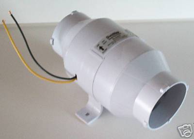

A few years ago I installed one of these between the heat exchanger and the duct in the bulkhead on my Trabant 601:
These things are listed on Ebay as either brake coolers, bilge pumps or electric superchargers. I don't know what there actual application is.
It seems like the one I installed generated more noise than it did air flow. I removed it. I think I paid less than $10 for it with free shipping.

Any of you guys installed one of these in your 2CV? Do they work? Any complaints?

Looks like what I tried on my Trabant. Maybe I should give it a shot on my 2CV?
I actually have a larger one that would not fit the Trabant and might be 3" diameter.
