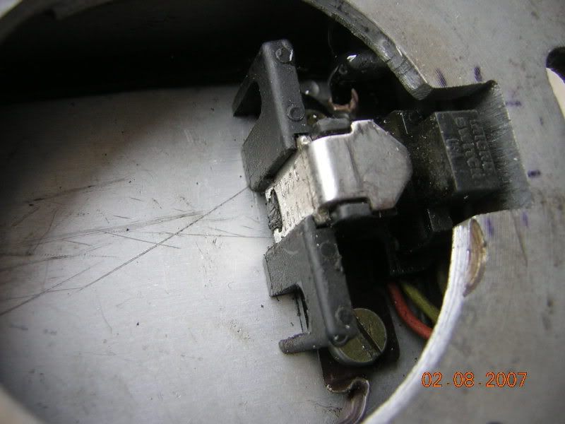

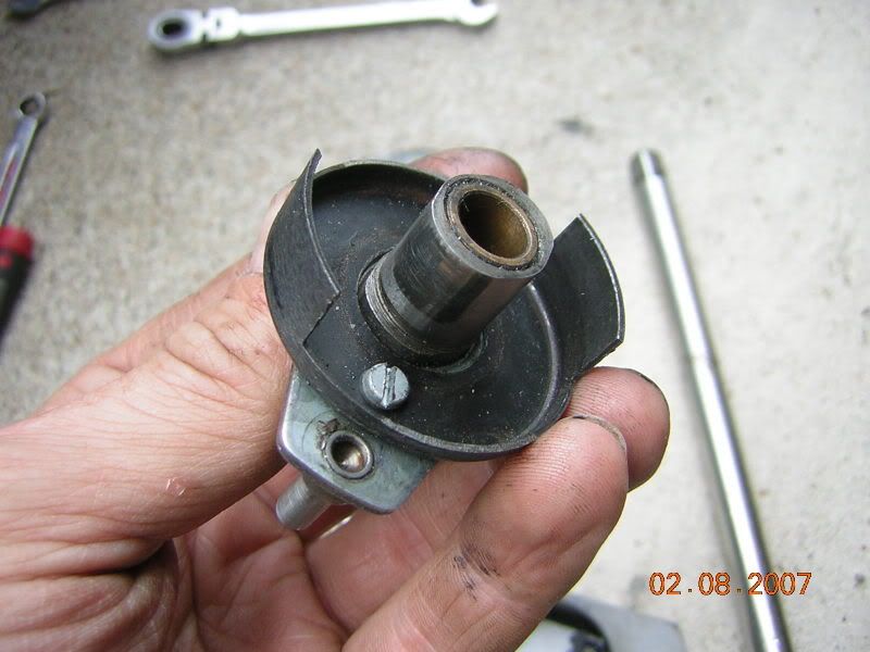

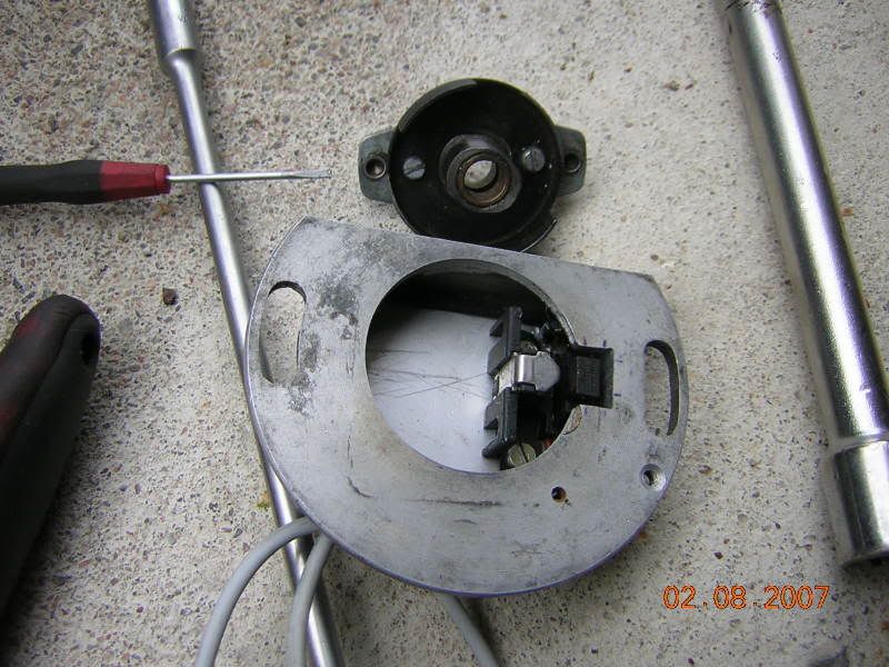

You can also convert oroginal ignition to electronic, and then have original advance control with "smart" dwell control and coil shutdown...
Like this
Trigger wheel to breaker
HALL-sensor to read the trigger
And the ignition controller
I have used parts from Lada Samara (can't recall the model name on other countries), also that ignition module (that Remitel -unit) is from Lada. Funny enough, all ignition parts are from car made in Russia but in all electric parts is label "made in u.s.a"... :lol:

That HALL-sensor is same in many distributors, and those Russian parts are full compatible with Bosch parts...
On my one project, I have tested to read original timing hole from flywheel by HALL-sensor from Opel sensor. In that photo, there was testing with Xm VR-both survive well there. But, if cranc has too much endplay, that isn't reliable solution, but without that it works well...
Those wirings on the ignition module -photo, they look horrible. I know. They aren't anymore like that, some rewiring has happened after that... :oops:

@Jasu Thanks
On UK Ebay Lada Samara new parts for IgnitionModule and Sensor are available.
What part did you use for the 2cv rotor plate? (picture 2) ?
