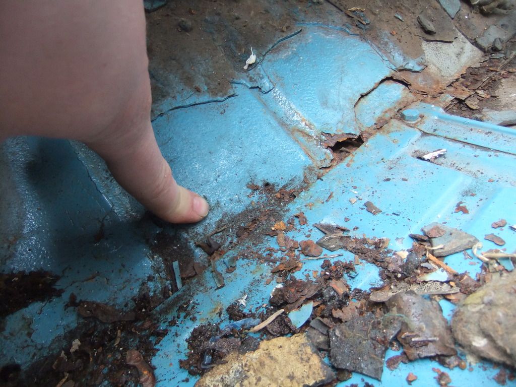

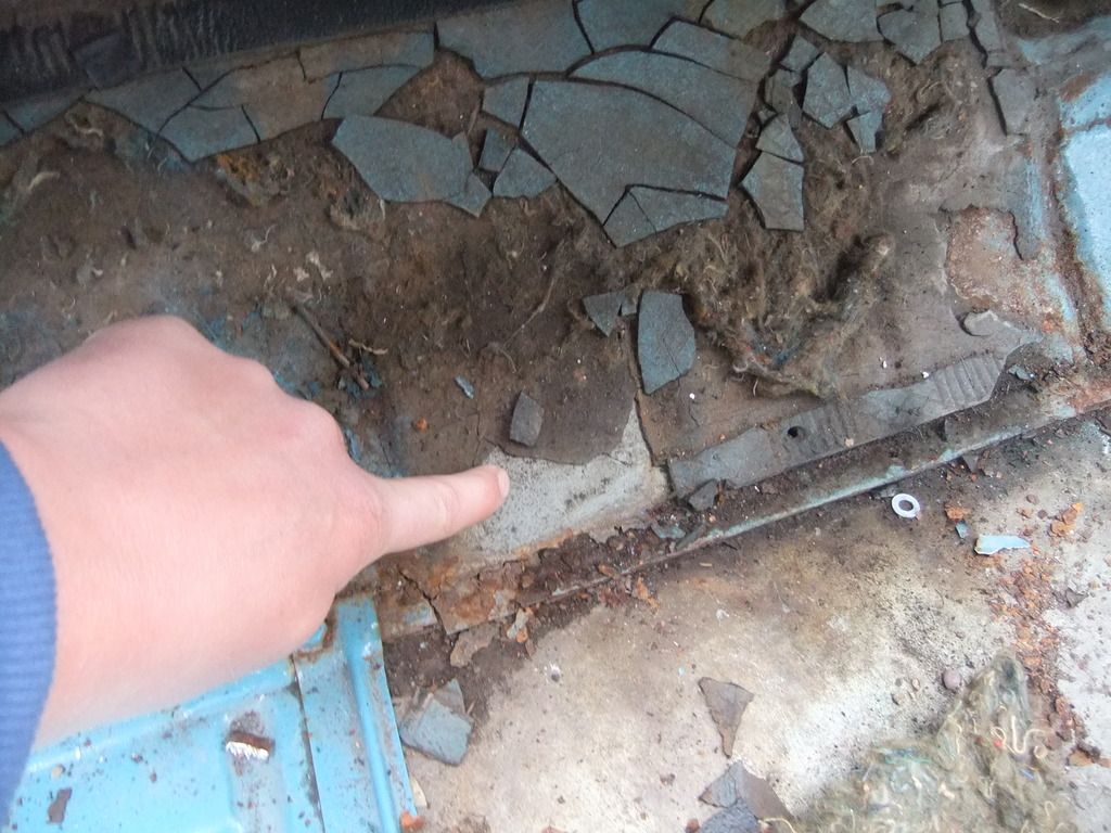

The lower most part of the bulkhead is definitely the worst part it is barely attached the passenger floor pan if at all and will push really easily where I'm pointing.

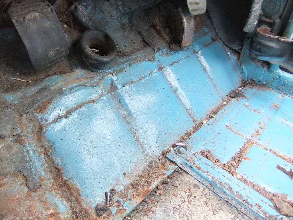

Moving over to the driver's side, that's better however there's an obvious patch but its solid but if I'm doing the car up, I'd like to improve on that a little bit if I can.

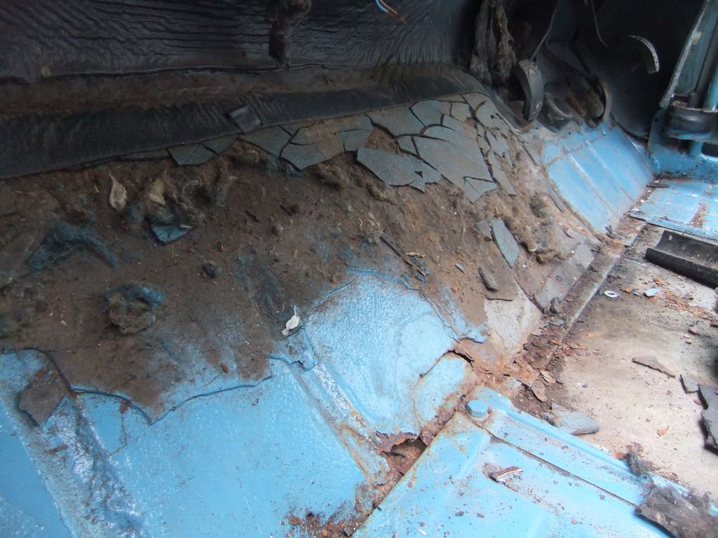

Moving to the other side there's corrosion on the N/S here.

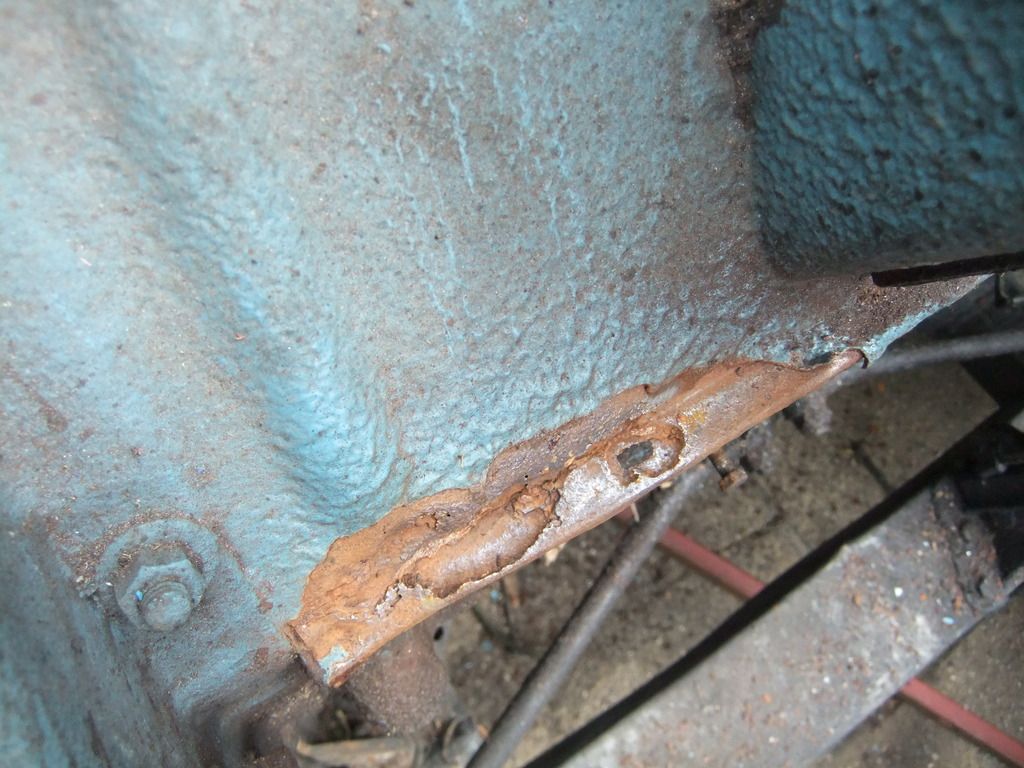

As well as were it meets the upper bulkhead here.
