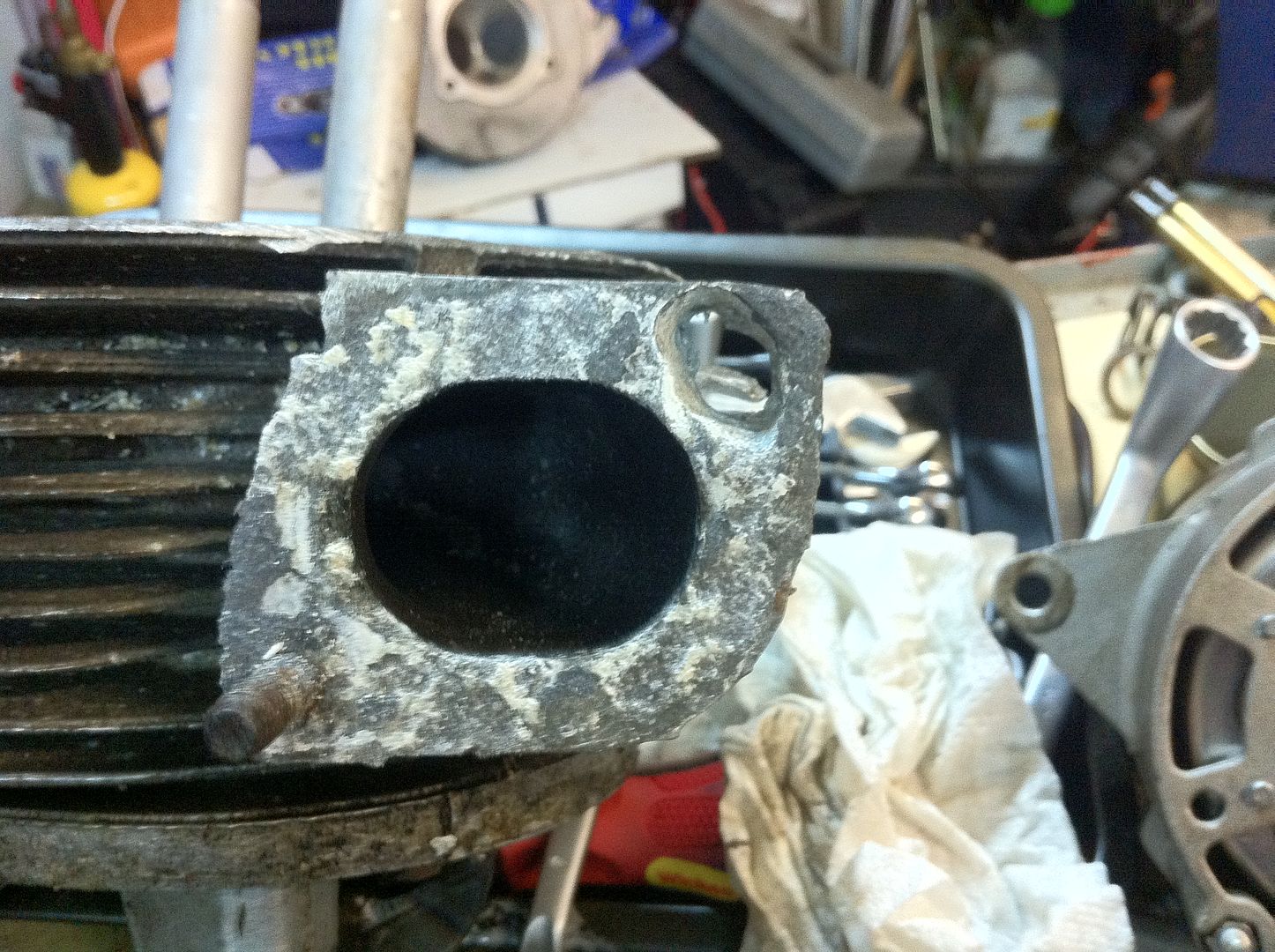

Just taken off the 2nd cylinder head from the spare motor in preparation.....
When you find the stud is glued in with firegum...
I've had better days... :lol:
November 7th, 2014, 7:19 pm
Posts: 2251
Post Re: Compression - I've had better days
That's repairable, get it plug welded (alu). Drill and tap.

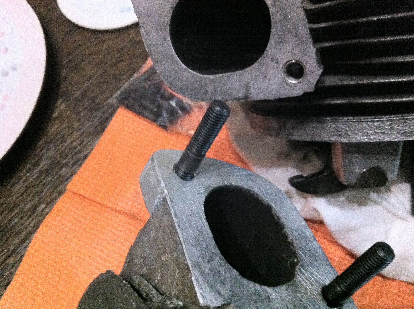

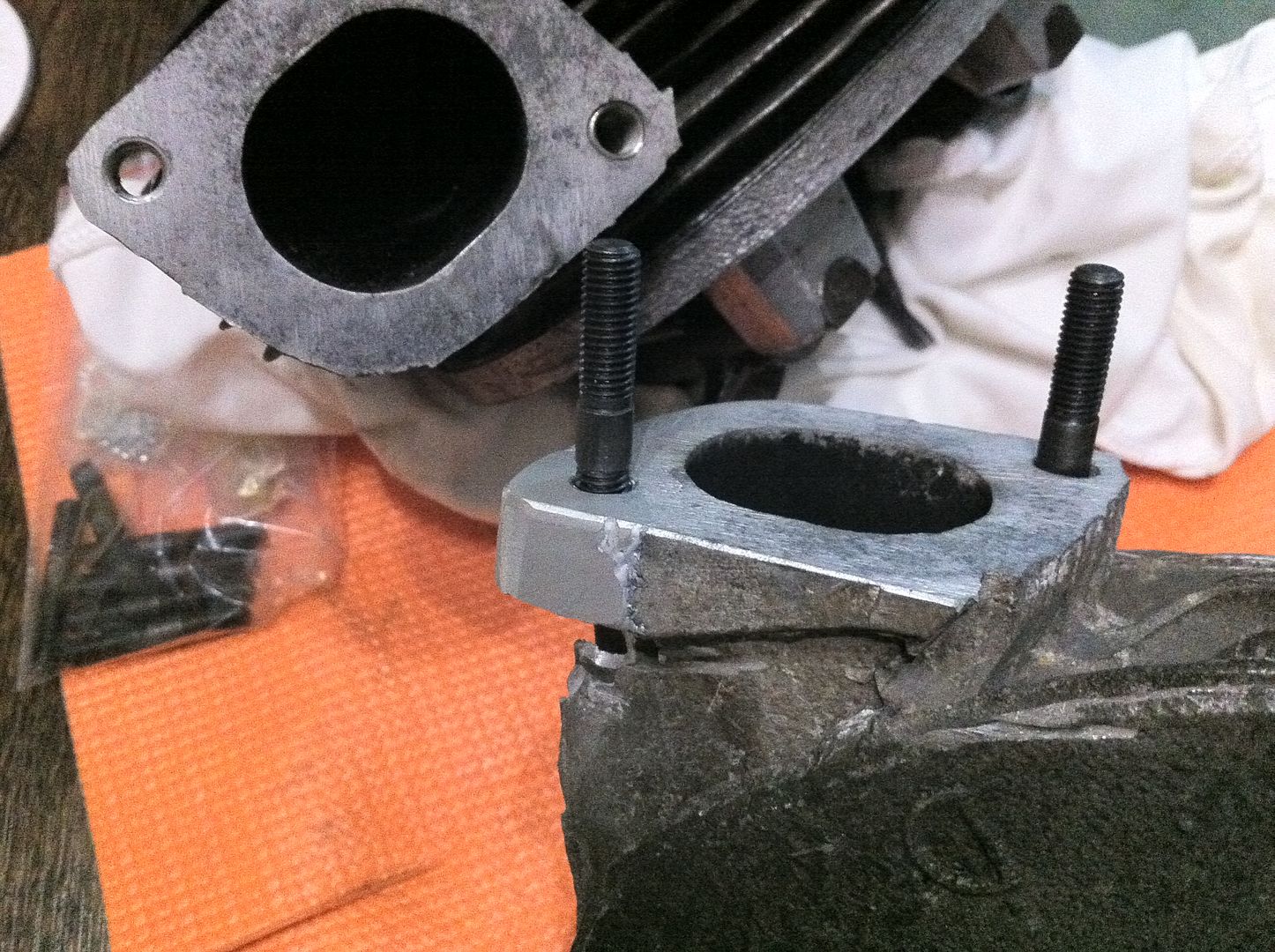

Sean wrote:
bolt and washer for the cheap bodge
Sean I'm shocked; that level of bodgery shows a lifetime of practice. :lol:
It's all welded up and all the M7 threads have been helicoiled for a bit of futreproofing.
I'll post a piccie when I pick them up on Sat.
November 10th, 2014, 11:39 am
Joined: October 31st, 2012, 5:31 pm
Posts: 79
All repaired
