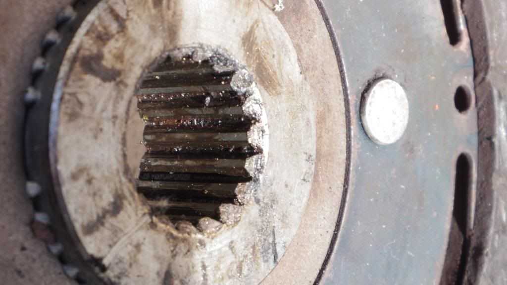

And how it looks when you get it wrong....

u,mm :oops: exactly like that in your pic nelsonbase :roll:
