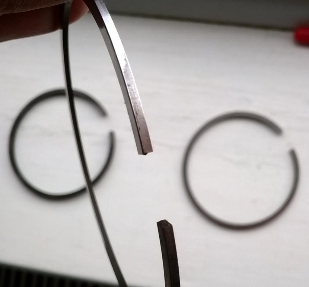

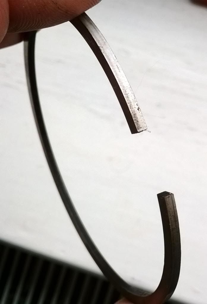

I bought a set of rings for an M28 and M28/1 engine. However, those rings are nothing like the fellers that I've removed from the unidentifiable engine that came out of the van.
These are the van's rings:
4mm thick. Internal diameter, as measured, 73mm (so must be 74mm when fitted).
2mm thick. Internal diameter, as measured, 72mm (74mm fitted).
1.5mm thick, approx. Internal diameter, as measured, 72mm (74mm fitted).
Can I just use the rings I've bought, or should I be buying different rings? ECAS website doesn't appear to have a like-for-like for the rings that I've removed.
