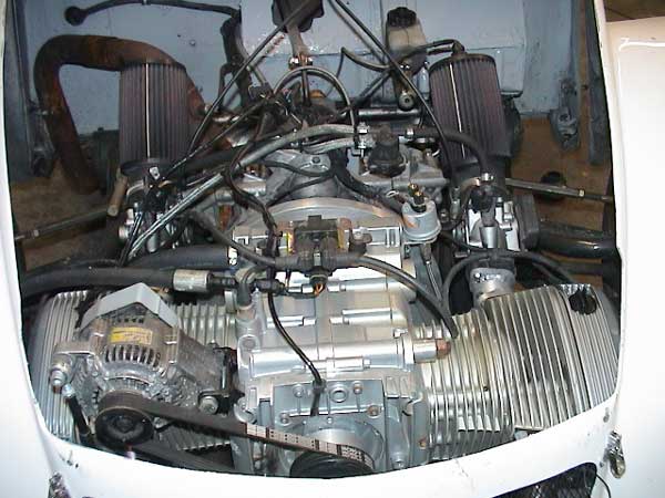

@Joolz
Looking at your adaptorplate, I thinks its from alloy and therse space enough to do a back engine mount
exhaust like this
only like this in the engine/bay otherwise my doors won´t open :lol: :lol: :lol: :lol: :lol:
alternator like this, (looks nice and clean)
p.s. didn´t hear anything from the scrapyard anymore.... so see what happens....
