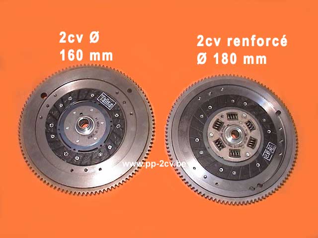

I know Joolz has done some research on this, many moons ago...
Thing is I may be getting a new flywheel machined up so I am thinking of fitting a larger clutch and pressure plate... Anyone know what 180mm clutch plate would fit a 2cv spline!?
My current setup is LNA gearbox with a Visa bellhousing and visa input shaft.
Here's a little inspiration!
Cheers,
Harley

Hi Harley
i have a feeling Ax and saxo 1.2 and 1.4 clutches have the same spline as 2cv
i will try to find out tomorrow
pony
April 12th, 2013, 8:44 pm
Posts: 816
Post Re: 180mm Clutch...
http://sailauto.en.gasgoo.com/auto-products/1651539.html
This could be an option!
Its from a Cherry QQ !? :?
180mm plate with 18 teeth spline...
EDIT:
Nissan Prarie Mk1 M10 All 1982 1988 1.5 Petrol 180mm 18 Splines 1982>1985
Nissan Sunny B11 All 1981 1985 1.5 Petrol 180mm 18 Splines
Anyone confirm or deny that these would fit!?
Harley
PS: Pony confirmed that the AX spline is .3-.5mm larger than 2cv therefore it doesn't fit! :(
