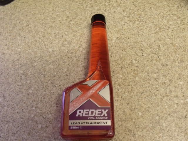

at the moment i am adding a lead replacement to fuel and using higher (more expensive) 97 or 99 ron fuel :?
is this correct or am i wasting money
as i was considering about buying these long term lead additive items that cost around £30 and go direct into the tank or inline on the fuel line but last for years :!:
what does everyone else do :?:
have been told to simply drop a peice of lead into the tank but not sure about that :|
not sure where i would get a "bit" of lead from nowadays as none left

I give my [1988] 2CV a dose of [Redex brand ] lead replacement additive every 3 or 4 tankfulls.
