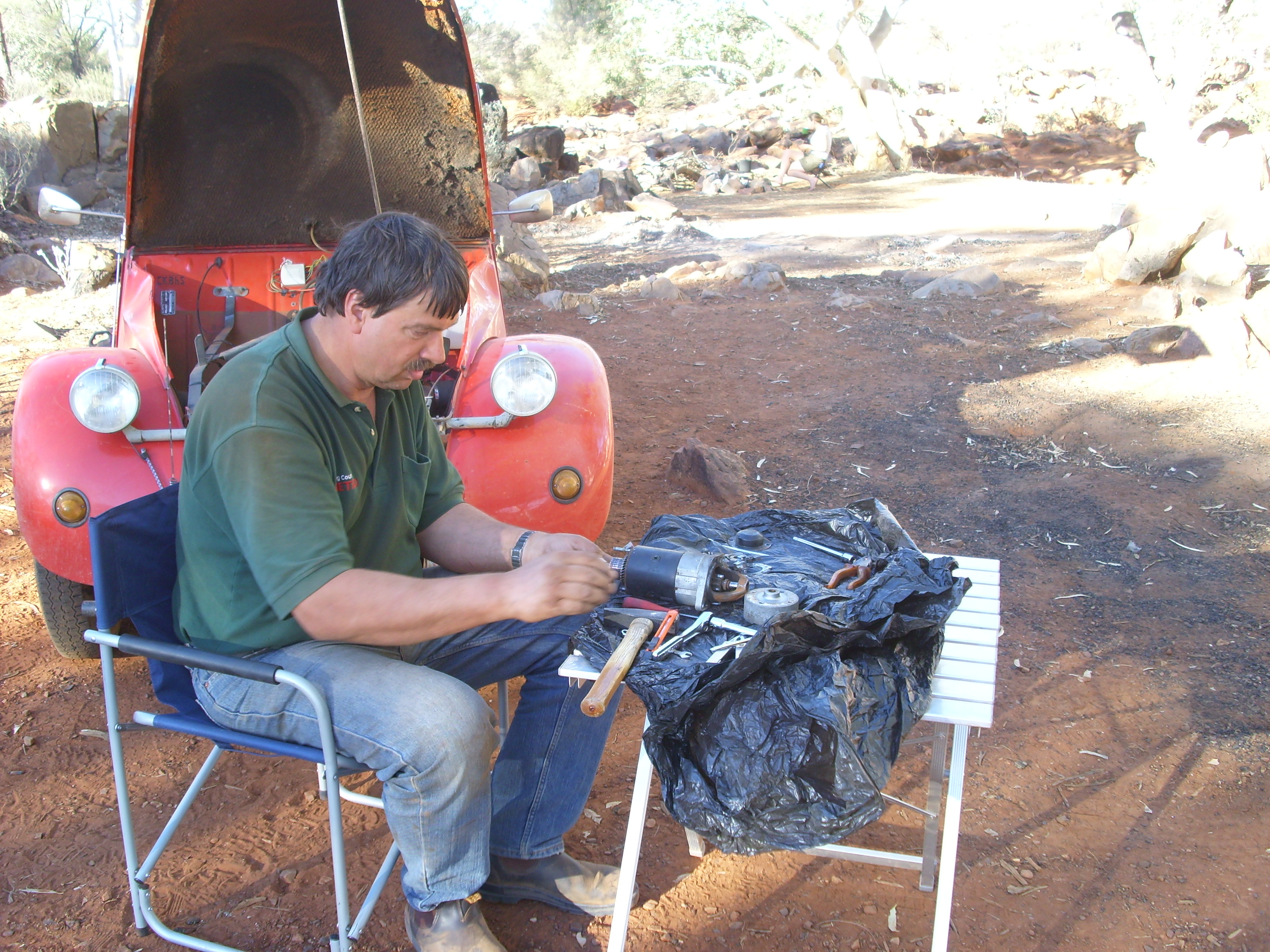

Cleaning a starter on the run (raid Oz 2008)
