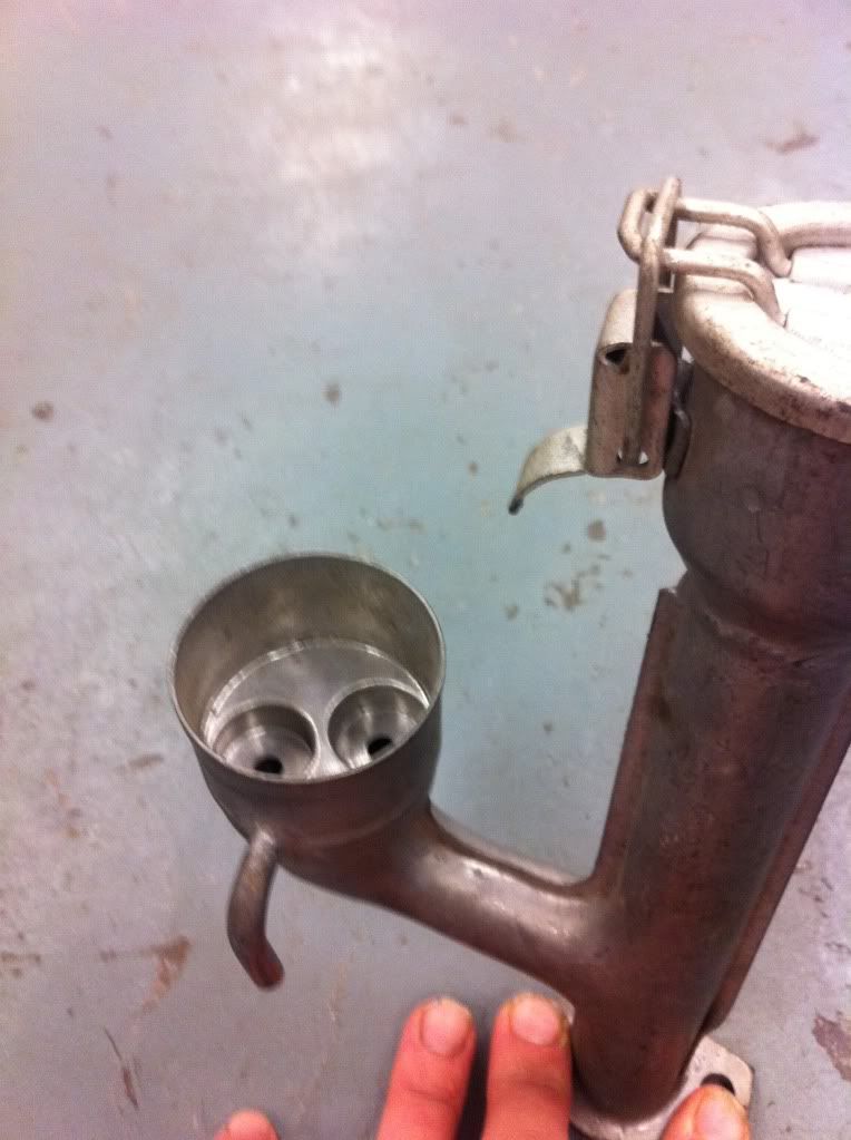

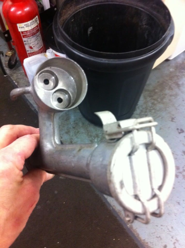

Can anyone tell me whats missing from inside this oil filler.
The one fitted to my van is the newer version and i want to change it to this type.I will say that its not the rubber flap type as in my AZ,even though the outside is very similar.The one I have bought has a small drain pipe at the base

Take a look at 2CV UK on Ebay. There is a unit like yours for sale. It would appear that there is a piece missing from yours

The 2 sniffer valves are missing

Ah,yes,I understand now.There should be two rubber valves,not one.The oil filler on my AZ has one single valve. :)

Dave - if you want to keep this I *strongly* recomend you buy a CPD valve and fit it between breather and air box. The duck bills are worse than useless. Mine runs so much better having got the engine breathing properly

But the way... STOP don't buy those rubber duck bill breather bits - you should remove them if you're fitting a CPD valve! just leave the domed cap on the breather.
