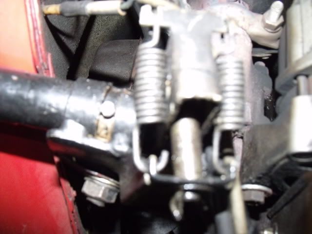

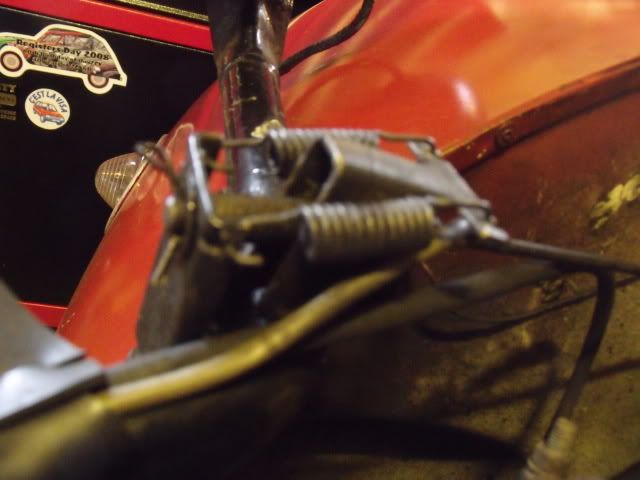

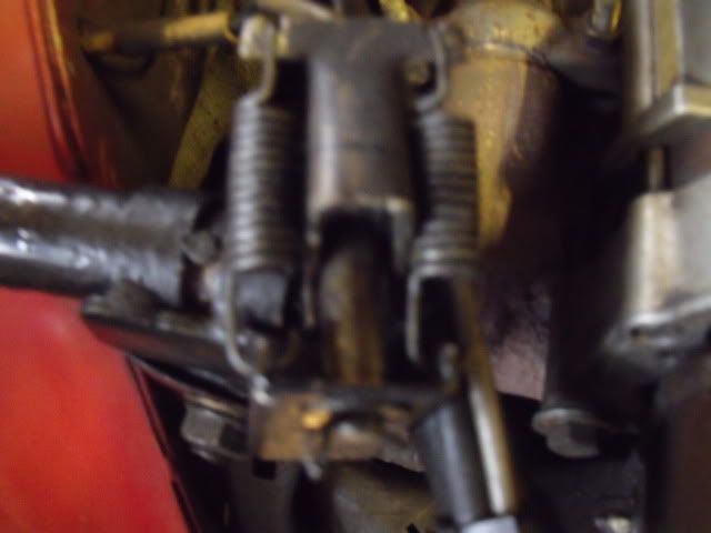

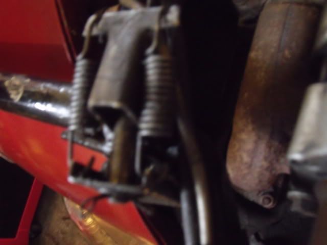

I am trying to reassemble a2cv rhd 1982
on the head lamp bar i have the threaded rod it screews into a barrel nut
it has a split pin hole in the end of the rod and i he the two springs on the headlamp bar
i am missing somthing or just getting old
well i have to say i did not take it apart (good excuse)
April 7th, 2012, 3:53 am
Posts: 498
Post Re: head lamp bar adjuster thing
There should be a bit of tube on the end of the rod acting as a spacer.

THANK YOU FOR ALL YOUR HELP
IT WAS JUST A BIT OF TUBE
WORKS GREAT NOW :D
